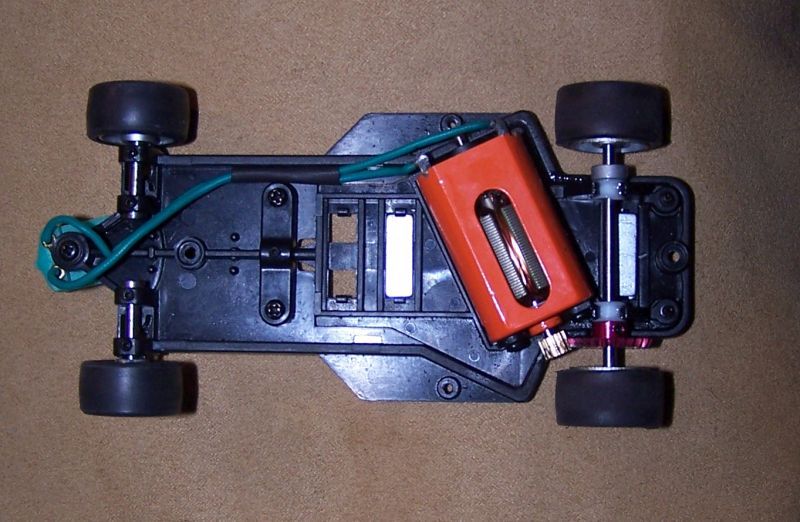

    I just bought the STP Kremer Porsche and I am very impressed with this slot car. It looks great and this chassis is much better than what I found on the Peugeot LMP. After lowering the front by adjusting the stub axle heights and switching to the spare set of tires it ran some very good laps on my wood track. I may just get the Mirage next month.

      I've always thought stub axles were kind of Mickey Mouse, but those look to be well designed and set up.
        Paul
        The Avant stubs work very well indeed, they are engineered not mickey mouse so +ve camber or neutral or -ve camber make your own choice to suit driving style. Not sure which camber to put on the bushes though.........
          Camber
          I realized right away that it is possible to set the camber with these stub axles and on an oval it might help. Right now I tried to keep the axles parallel to the track surface.
            No camber...
            Have you tried replacement with a solid axle??
              No, the car behaves perfectly well with the stub axles.
                More camber is always better!

                      One final note. About the only place on this car where they opted for cheaper parts is the rear bushings. They are nylon and the axle was very sloppy causing wheel hop coming out of the corners. I did a temporary fix using CA glue at the axle bushing contact point achieving the needed tightness. But knowing that it wouldn't hold up to the torque of the motor I ordered a set of slotting plus bronze bushings. After installing the bronze bushings the car glides out of the corners with no wheel hop making it easier to drive and capable of some very fast laps.
                      I guess the money budgeted for this project ran out and they had to go with the cheaper nylon bushings.
