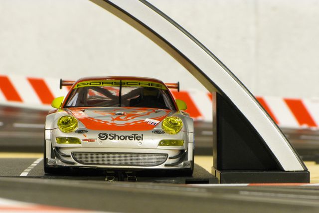

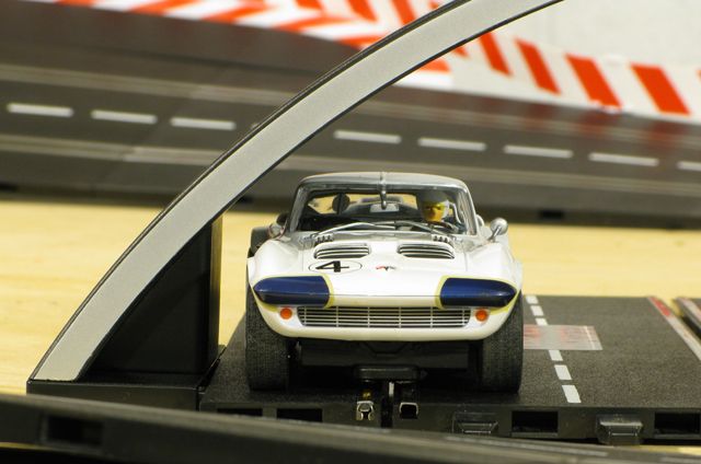

    I was asked about the clearance of 1/24 cars and the new Startlight. Rather than bury that answer there, since I thought it would be important and a question that would come up again, I thought I'd post these photos here.
    I'd say that clearance would not be an issue. But putting the Startlight just after a corner where the cars would most likely *not* be going in a straight line probably wouldn't be a good idea. After the start/finish line at the end of a straight would be the best bet. The cars do have plenty of room to clear the sides of the Startlight gantry.
    Thank you for posting the pictures! That certainly answers my questions about how the Startlight would work when using 4 lanes and the larger 1/24 scale cars. I think this should have its own thread to make it easier for people to find.
