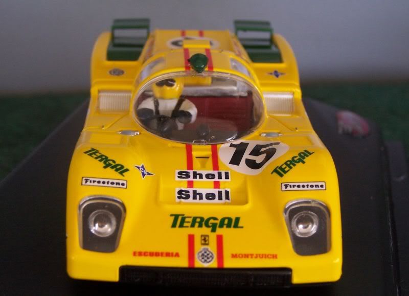

    I have been looking for a while for a Ferrari 512 M to complement my Fly Ferrari 512 S Coda Lunga but most of the one's I have located on E-Bay the seller is asking well over $100 which is beyond my budget. Last week during a Google search I found an online hobby shop (NCP Hobbies) that listed just a yellow Spirit Ferrari with the part number and no picture. After verifying that the part number was for a Ferrari 512 I went ahead and ordered it for $56.95 plus $8.75 shipping. It arrived on Tuesday sealed up in it's jewel case having never been touched since it left the factory. Upon removing it I discovered that it had been sitting screwed down to the base for so long that the tires were flat spotted and needed replacement. The gear mesh was horrendous so I swapped out for a replacement Scaley gear. The car runs fairly well now so I will be getting a set of replacement rubber and see whether it will keep up with it's Fly cousin.
