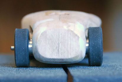

    Here are some progress shots of the master.
    I think the body looks a bit thick... but I don't know. Judging from this photo taken at Laguna Seca it is. However I know motion shots taken tend to look a bit stretched. I'm gonna have to do some thinking...

    I'm with you, it does look thick...still great work as always!

        Must have spent 20 minutes looking at that master, I used to do these in basswood for vacuformed bodies and it is an art. Does look a little high on top and based on the shot you have there the line is less curved. The back is coming along very well as is the front. Whatever you do it will come out fine, your models are always great.
        Is that one solid piece of wood? I used to use the various sizes available and glued together to get the basic proportions then carve. I would have it looking perfect only to discover one side was higher or lower than the other till I changed my method. What really throws you off is when you compromise one area for say wheel or chassis considerations the whole thing can look odd if you don't compromise elsewhere. Whatever you ask for the model when it's done really can't begin to pay for the time you put in to make it. I will be in line for at least one.
          Yeah... I think the issue is the upper part was too bowed. I flattened it a bit and it looks much better now.
          Yup. It's one piece of bass wood. I'm trying to carve the fenders from a 3 layer lamination of 3/8" basswood. It's kind of working. It maybe too fragile for long life so, I may go with epoxy putty shaping it initially by hand then finishing with files and the Dremel.
          I understand what you'r saying... so far I haven't run into that problem. Keeping everything balanced takes time, careful measuring a good eye
