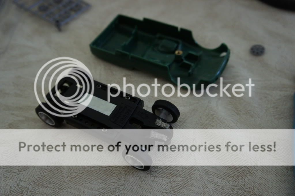

    I acquired a MIB Strombecker lotus 19 that needs a chassis. I tried an original Strombecker competition chassis, but that did not look right at all, the ride height was waaaaaay too high. Disappointed that I couldn't go all old school, I decided I'd try a modern chassis. I wanted brass to keep the old school look and feel, but I wasn't sure what universal brass chassises would fit, and I don't build them either. So I opted for the new MRRC universal chassis kit. I also bought some SCC insert wheels in 15x8. So far I like the results:
    FYI... those mini-lite inserts are from MRRC, and they fit the SCC wheels perfectly. Just wanted you scratchbuilders to know.

        Interesting adaptation. So what did you use for the rear body mount? It appears you had to cut away the one that is on the Sebring chassis.
        Scott

            Yeah, I haven't decided how to mount the chassis. I just know I had to remove the rear tab. I'm thinking I'll use some L-shaped styrene plastic and mount the chassis in the sides of the body. Unless you have an alternative suggestion, I'm all ears.

              I'm assuming the front mount works OK. If so, then perhaps just gluing some very dense foam on the inside of the body sides and perhaps above the motor will be enough to keep the rear tires from rubbing. Unless you plan on crashing hard a lot, that one screw should be enough to keep things together.
              Those old Strombecker bodies aren't styrene from the feel of them so standard glues that one would use for attaching body mounts might not hold.

                The front mount appears to be ok. As for glue, there is one glue that works on everything: SHOE GOO! I'm gonna have to fiddle with the body and chassis before I settle on a method.

                        I think the wheelbase is about right. The Strombecker body is not perfect, but I like the look. Not going for perfection.
                        This is how I adapted the body to the chassis. One screw does hold the body to chassis. I crafted the cradle for the rear of the chassis and shimmed the chassis to raise the body up in the front. Used SHOE GOO for glue.
                          That bracket looks like a good solution and keeps the rear wheels from rubbing. I"ll have to give this a shot at the next slot car show in November. There are always Lotus bodies being offered for a few dollars.
