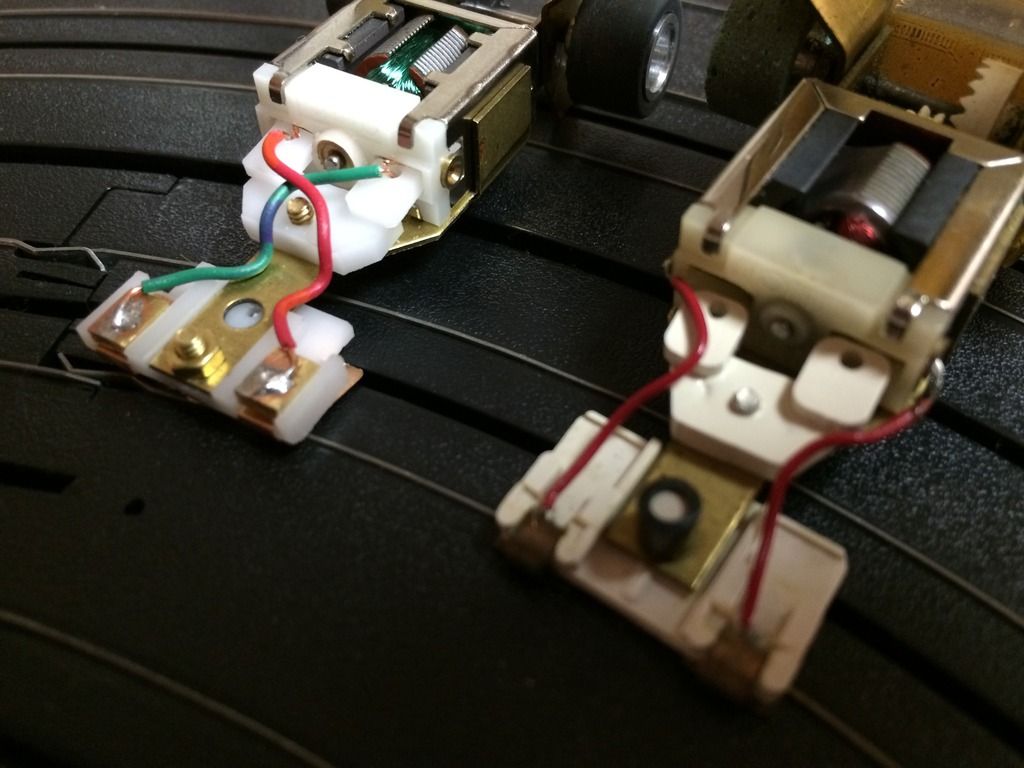

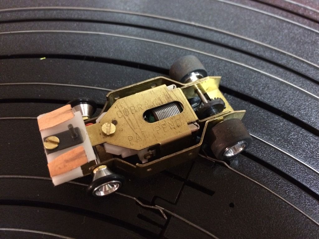

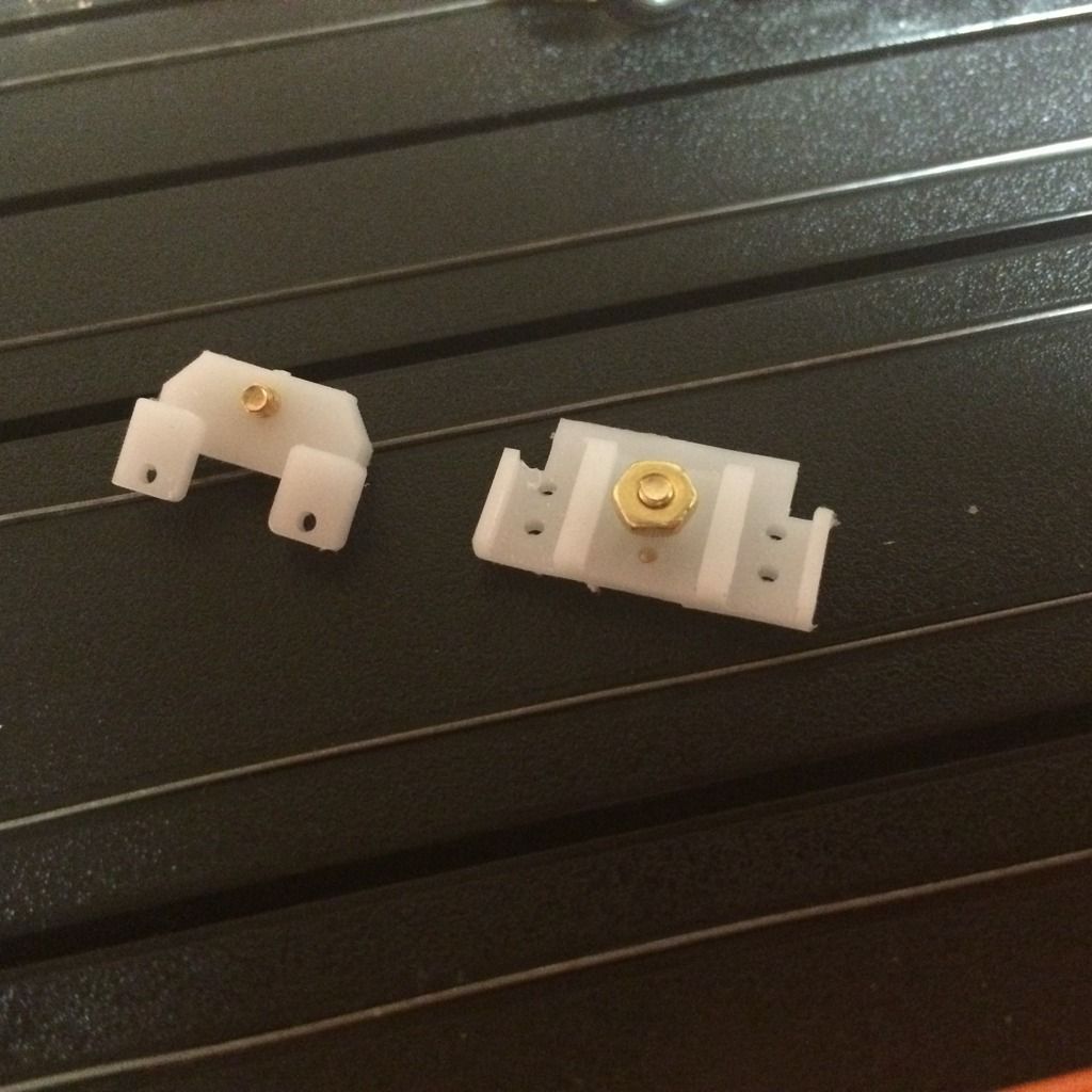

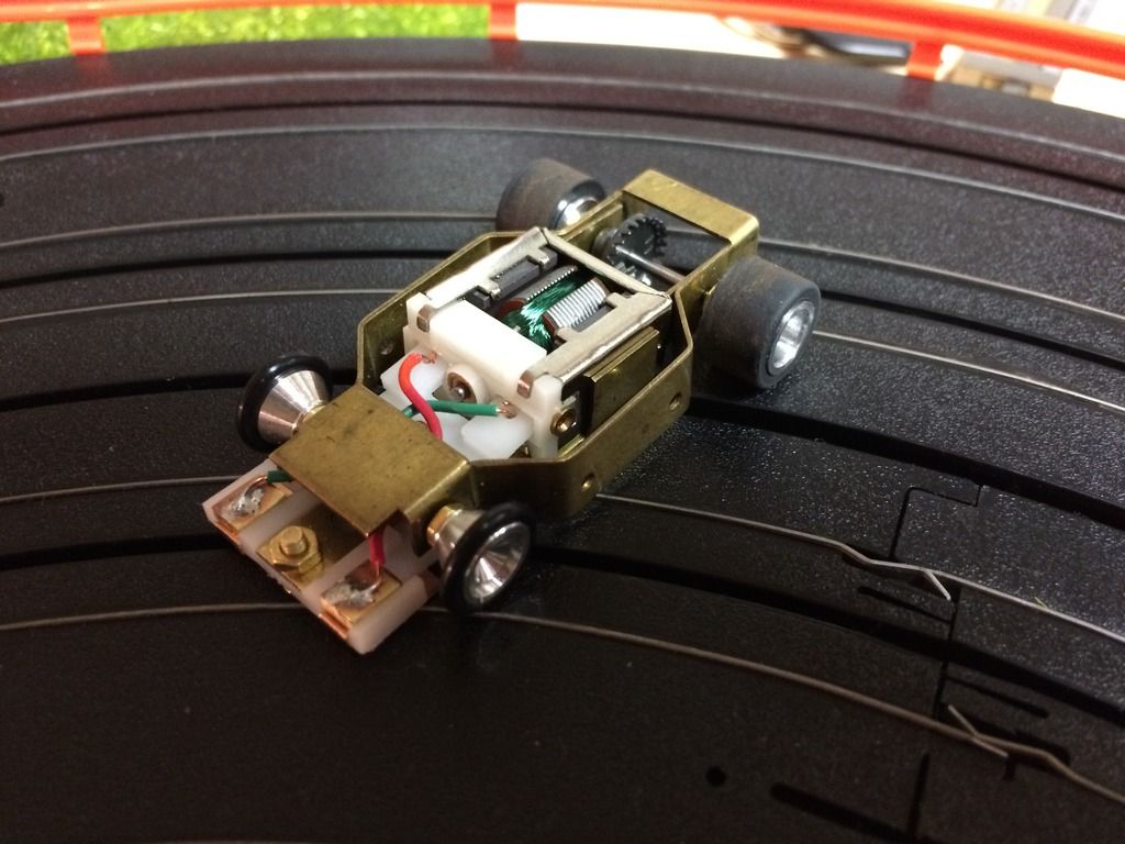

    I received a bare Cobramite Chassis from a fellow Brass builder, and I needed to recreate the plastic pieces. So I took some liberties and did a redesign as well as worked on the fitment of the components. Here is a pictorial of the build:
    Here are the original parts:
    Here is my take:
    Side by side:
    Finished build top:
    Finished build bottom:
    The hubs, axles, and wipers were also parts that were machined for this project. I ended up doing three builds altogether. The wipers are held in place by a snap feature of the top block. The wipers themselves are stamped out of a sheet of bronze. They are modeled after the Tyco Pro wiper.
