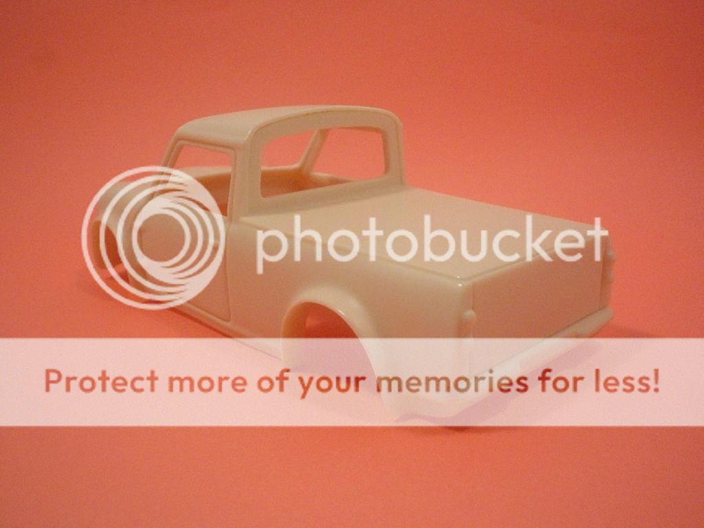

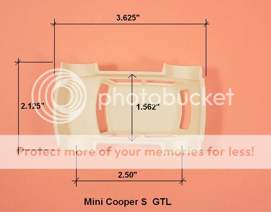

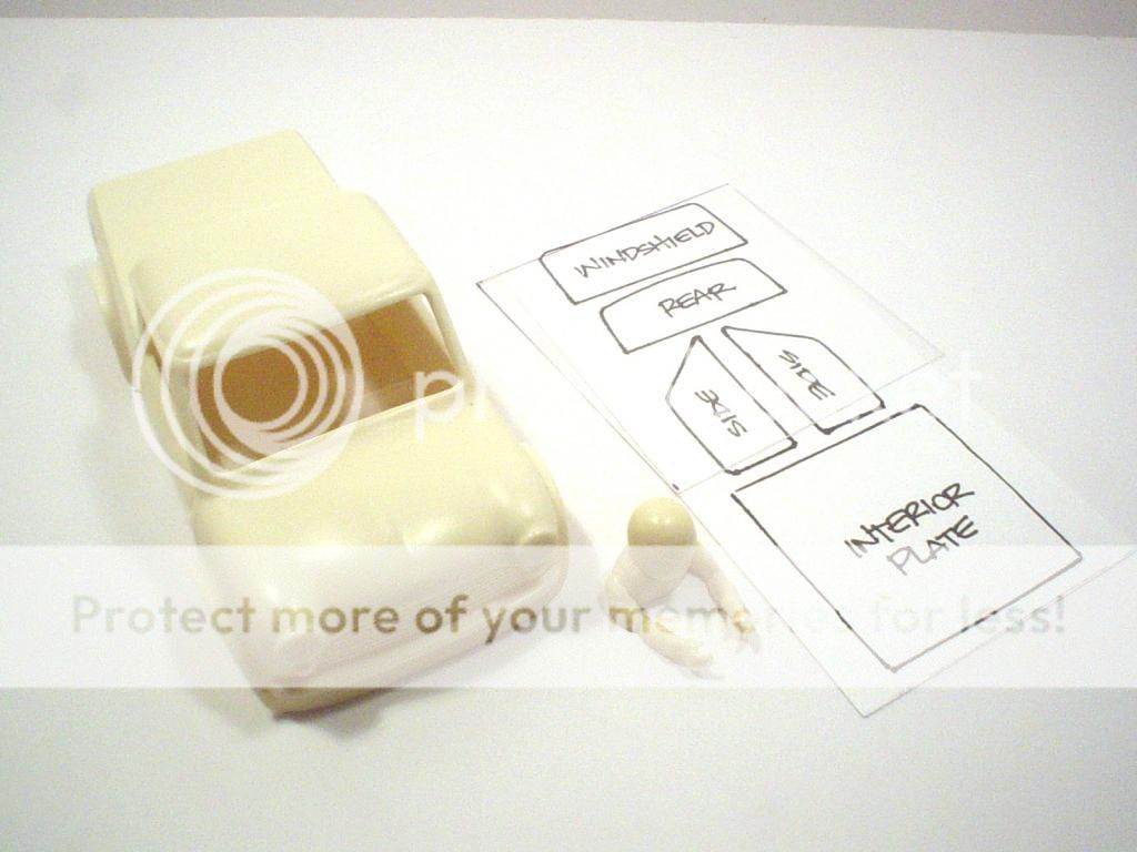

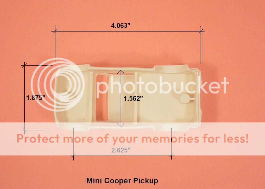

    Just found some newly available 1/32 Mini resin bodies. They're from Bruce Kinder, a seasoned resin maker of 1/24 resin model items. This is his first foray into 1/32 after some nudging from a slot car friend.
    GT5 saloon
    Pick up
    No problem for either body meeting the U or Ux class body dimensions.
    For more info, contact Bruce directly at [email protected]

          Those are great looking Mini casting from Bruce. They look to be very well detailed and even walled. How do his prices compare to other Mini bodies out there? I assume either of the two would be UX class because of the flares.
