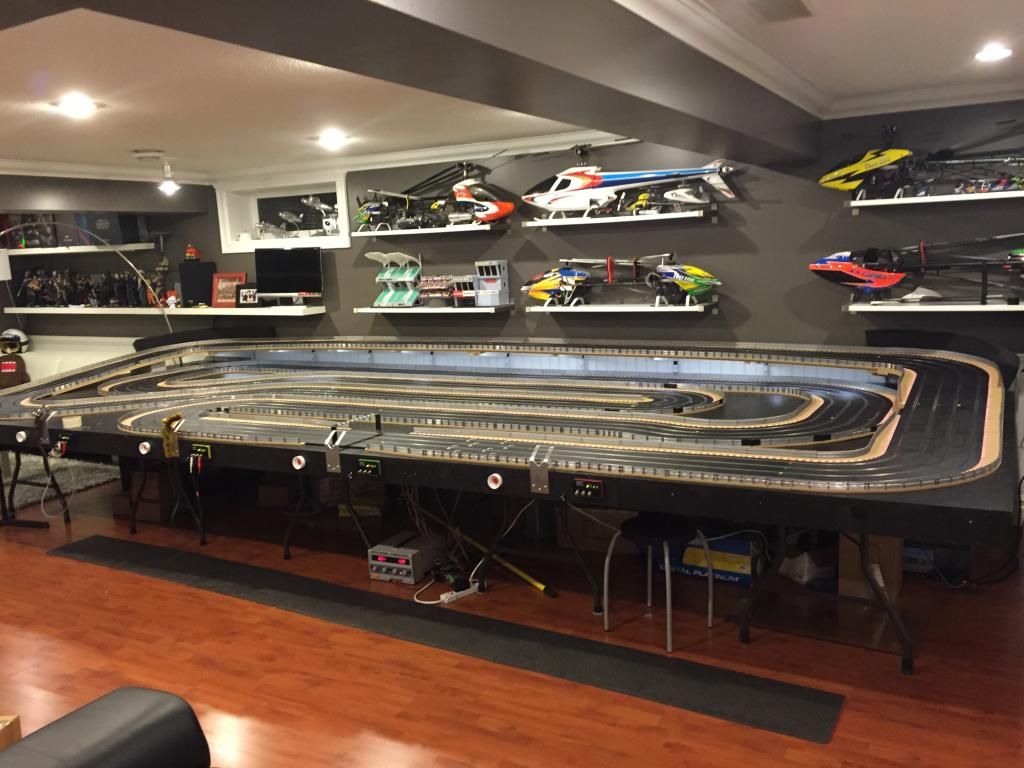

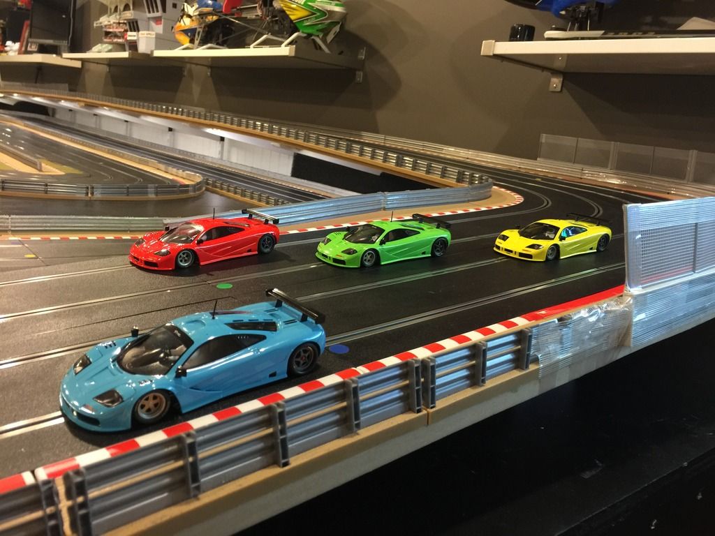

              The cars look and run great!
              The cars are very smooth and corner very well, with no weight, just backoff the pod screws a 1/4 turn, and putting on urethanes.
              The cars are about .70 seconds faster than the Mazdas on my track. Mazdas ran 8.7 seconds and the McLaren runs 8.0 seconds. My track is a 4 lane 108 foot scaley track.
              I put on some smaller wheels for the front from spares from the MSC Mazda that I had lying around and put rubber on and trued them on the Hudy so that the axle sits as high as possible, with two set screws from the bottom at the two outer holes. This puts the guide and braid down to about flush with the bottom of the rubber of front wheels on the tech block, on tracks with recessed braiding you might choose to put a guide spacer to lower the guide. You can see the smaller wheel on the front of each car in the first picture. I did also put a washer under the front mounting post of body to give some clearance to the sides of body near the back of the front wheel well.
              So far I have ran them on my home track and the club Routed 4 Lane track and I am very happy!

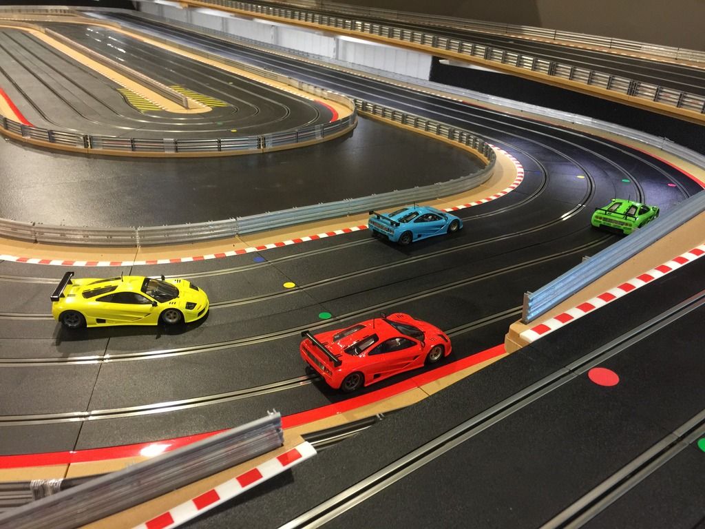

                I've had the pleasure of seeing all available colors as I sell those cars. They're very nice and bright colors. I particularly like the red. Like Alwyn said, attention to details is fantastic, on the mechanical side of things as well as for the body. Very well made, all-around.
                With minimal tuning, this car is one of the fastest on my track already. The front wheels have not been a problem for me as I always adjust the front axle height before putting the car on track. I added some oval point set screws right away, did a little truing on the front tires and I never noticed the rubbing once I put the car on track. On the other cars I have, I can see what you're talking about.
                But it's an easy fix.
                I also like the body screw in front of the guide. I would have preferred only one body screw at the back for easier float but I can see why it's better with two, the way the motor pod is made.
                The body feels robust, the chassis is also easy to manipulate and doesn't seem fragile. The build quality is definitely higher than average. Great job Ernie!
                The motor is fast and has a good power curve. I'm not a fan of the anglewinder configuration but I'll probably keep it just to keep this motor in the car. I will also try an inline configuration to see if I can get the car to be even faster (I like inline cars).
                All in all, this car is without a doubt a fierce competitor to the best slot cars out there. It will be able to stand proud against the fastest and the next few months will confirm that.
                I've already decided that this car will be the official car of the 2nd annual Slot Car Corner Canada Proxy in 2016. Start tuning!
