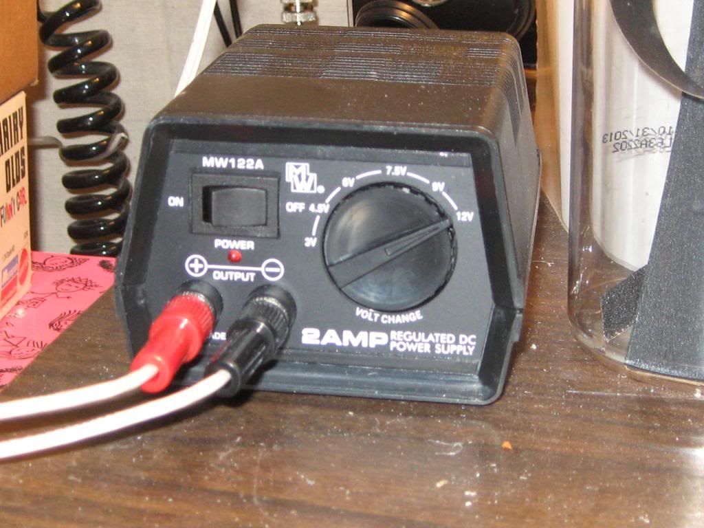

                            that wimpy (IMO- lol) P/S shown will run my tire razor down to almost stall at the 4.5V setting, but not at the 6V. they are cheap, though. other machines may (and some do) draw a lot more current, depending on the electric motor, multiple belts and shafts, etc.
                            I added a small, self-powered inexpensive surplus 3-digit LED panel-type Voltmeter to this thing so that I can keep an eye on it. at least these supplies don't fold back; they just run out of steam sometimes.

                            i use the MW122A for other things (such as breaking in cars). it sits nicely on top of the tall one with its meter tacked in front, once I added a set of rubber feet to it. it runs a lot cooler now that air can get in the bottom as well, so I've done this to a couple of 'em.
                            speedy
                            as an aside, I've bought a total of four of these things over the years, and paid a lot less on average than good Jon did. one I modified with a control pot replacement for the clack-clack Voltage selector.
                            one serves the purpose described above, one charges/maintains NiCad battery stacks, one I gave to my buddy for his HO cars, and the last one I melted down because I walked away leaving too steep a load on it. like I said, they're cheapos, so they don't have any brains.
