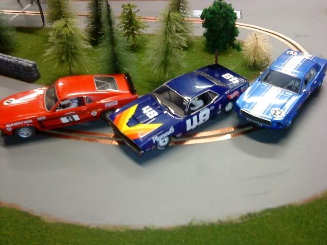

    I thought after picking up my SCX Cuda today I would give it run with my Scaley and Pioneer Mustangs
    first off I will list what mods have been done to each car
    Scaley Mustang
    TR Racing tyres
    trim chassis to get float
    trued front tyres to allow guide to sit fully in slot
    moved pinon across and shimmed rear axle
    removed bumpers
    added 3g's of weight to the front
    glued motor in
    Pioneer Notch back Mustang
    TR Racing tyres
    Scaley mk1 escort front tyres trued
    Trimmed Chassis
    Lowed the car by 1.5 mm
    7mm deep guide
    2g's of weight under the drop tank
    removed dpr plug
    glued motor in
    SCX Cuda
    TR Racing Tyres
    Trued front tyres to allow guide to sit fully in the slot
    Hard wired motor
    Trimmed chassis
    Solid front axle
    added 2.5g's to each side of the pod
    Speed trap Report
    Scaley 345k's
    Pioneer 312k's
    SCX 337k's
    So it seems on this track the Pioneer's motor is punchy but lacks the top end vs other 18k motors but the scaley seems to have the most grunt on the track
    Sector 1 on my track needs a car that will break well and put the power done out of corners really well
    Scaley 3.731
    Pioneer 3.588
    SCX 3.672
    The pioneer car was tops on putting the power down and mid corner speed seemed best with the scx but it chatted a little on corner exit more tuning will improve this
    Sector 2 on this track is pretty open with the 2 longest straights with a banked sweeper the speed trap is at the end of the straight after the sweeper
    Scaley 1.081
    Pioneer 1.188
    SCX 1.090
    Its pretty close here the Pioneer Mustang was the nicest through the banked corner but it was a bit slower in the sector mainly due to the slower motor
    The rest of the track is where you need to control the tail of the car and control a few slides
    Through this section the SCX seemed to have the most grip and was the easier to control slides but the scaley did not handle this section as well as the Pioneer car
    Total lap times after doing 30 laps with each car
    Scaley 6.401
    Pioneer 6.388
    SCX 6.291
    Its really hard to to say no car is way better then the next i say its down to what type of track your racing on. As you can see with how the cars work on each sector of this track
