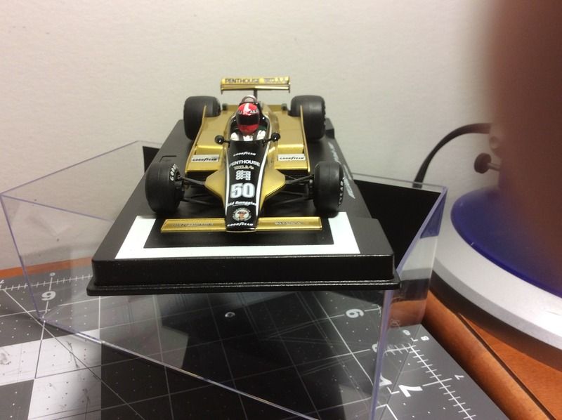

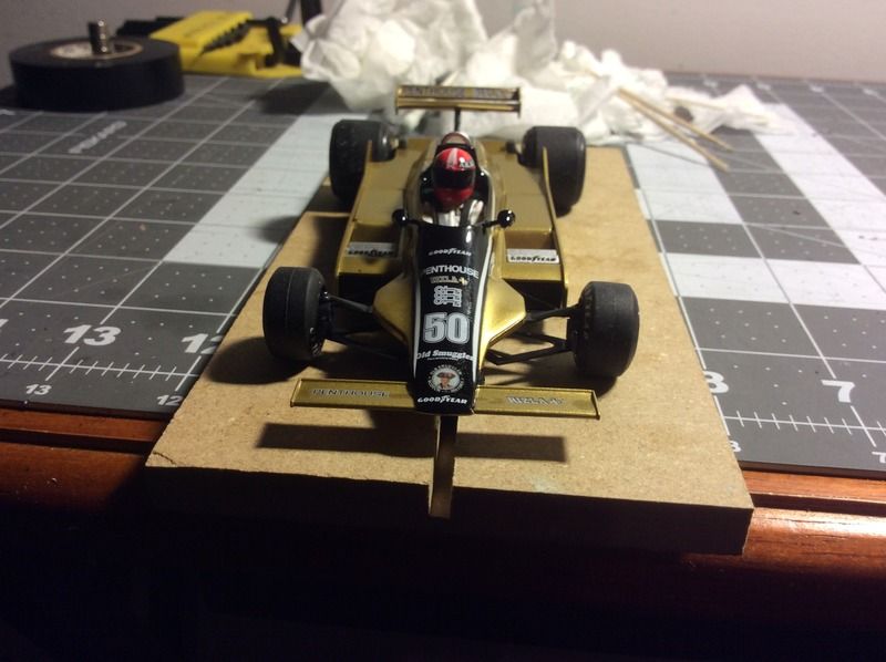

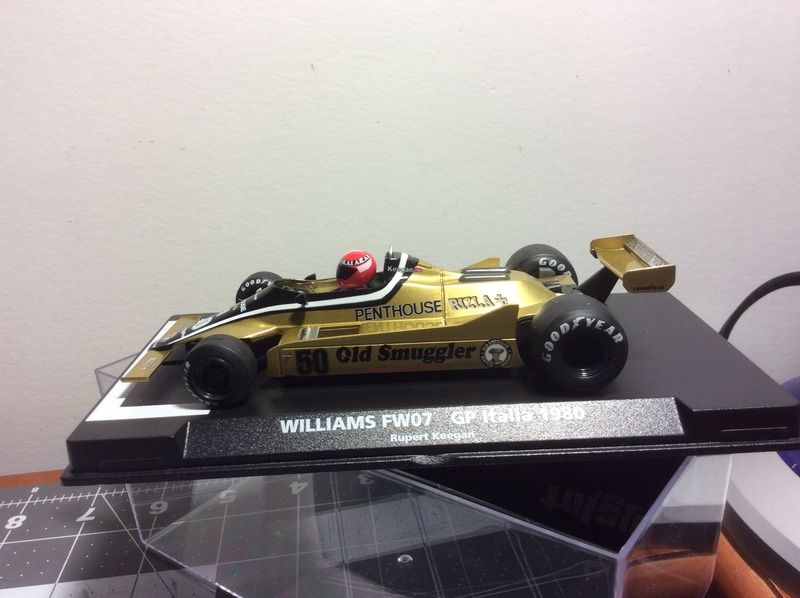

    Once we get the car off the plinth, we see what we have to work with:

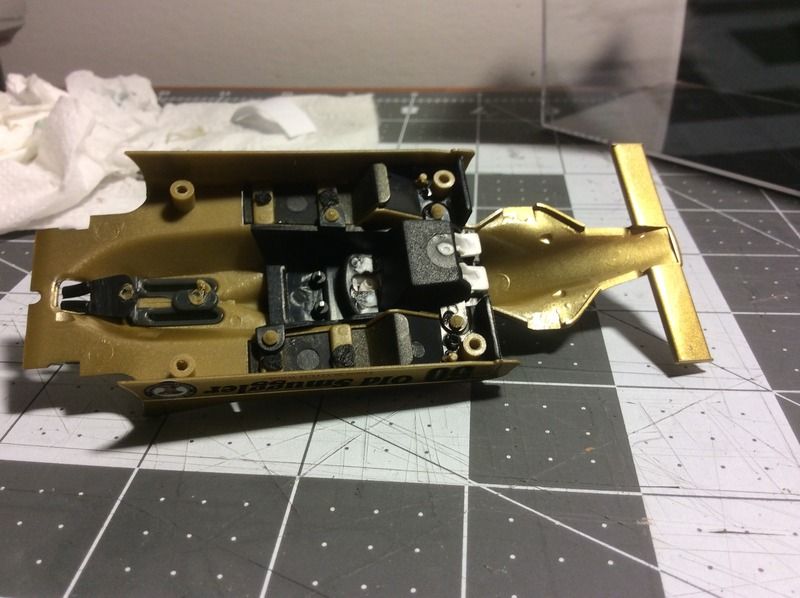

    Where to start...I started with the most problematic area...the gearbox. I took the body off and turned the gears by hand. Surprisingly they weren't the worst I've seen. I put the car on the track under 6v and yikes, what a grumbly noise.

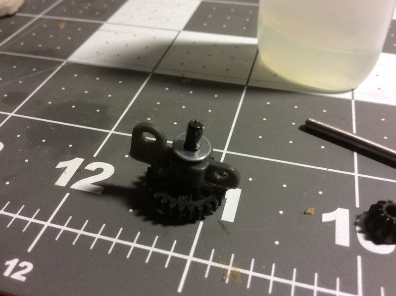

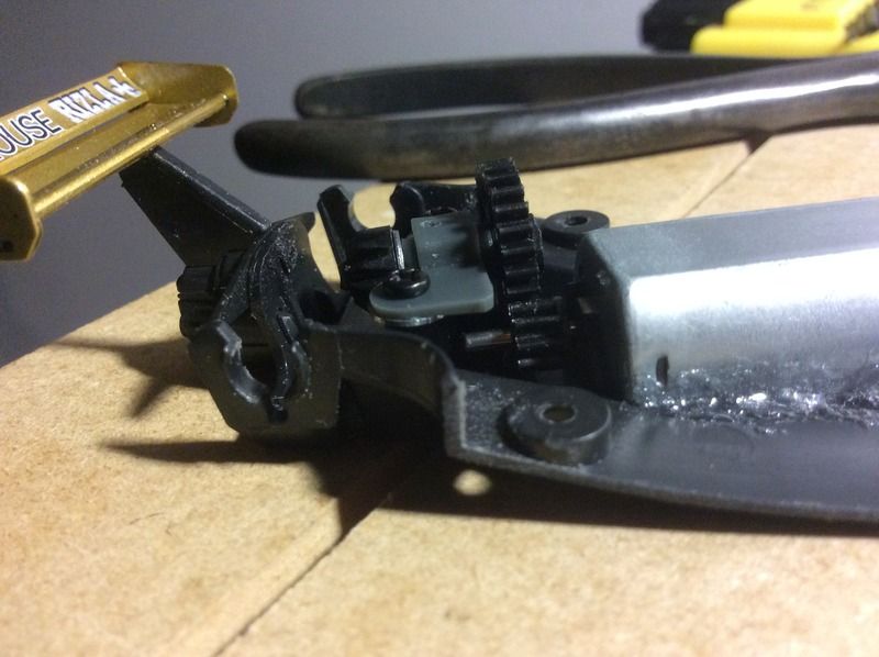

    So back to the work bench. I started by removing the gear box with the idler gear which is affixed by two philips head screws.

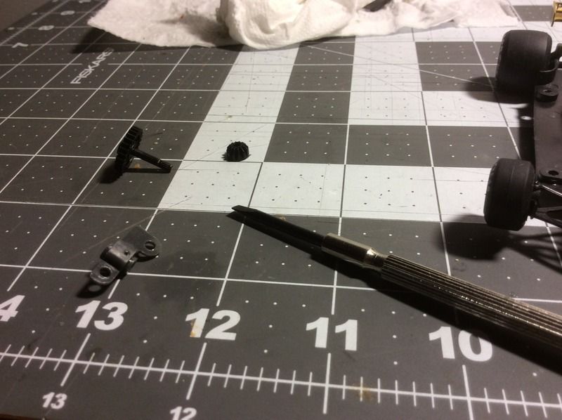

    Using a flat head screw driver and holding the spur gear in my other hand, I used the screw driver to pry and push off the smaller gear off the splined axle.

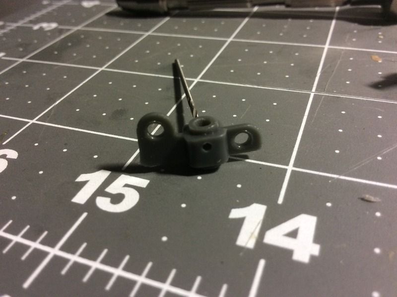

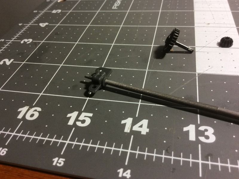

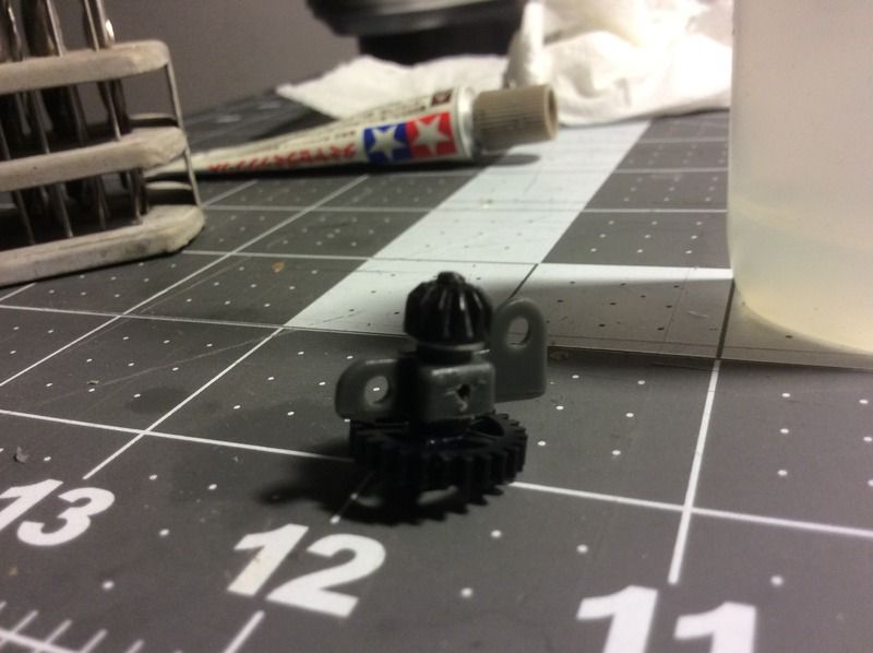

    I noticed straight off, that the axle hole in the plastic piece was tight and the axle didn't spin as freely as I'd like. So, out came my rounded jeweler's file to sand the opening / tunnel where the idler gear axle runs through.
    On top of the plastic piece, there is a very small hole. Which is supposed to be where you'd apply the oil. So, to fix this I used my smallest drill bit to open up the hole a bit more.
    Then after, I decided to make another hole in the opposite side:
    So, now we were ready to reassemble the gear box, but before that happened - I oiled and put a small amount of grease to help things spin.

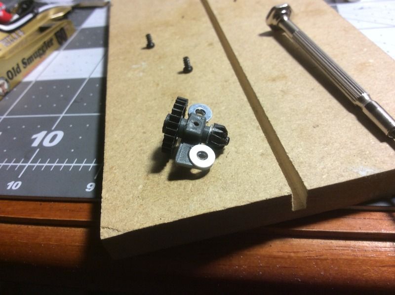

    Before I pressed the smaller gear back on, I used an axle shim to help keep the smaller gears aligned.
    A word to the wise here, make sure the idler axle doesn't poke out beyond the small gear otherwise it'll foul the rear axle.
    Then before I screwed the gear box back into place, I put an axle shim under each screw (something I picked up from another forum) - believe it or not, raising the gear box helps the overall alignment with the spur gear and the pinion from the motor.

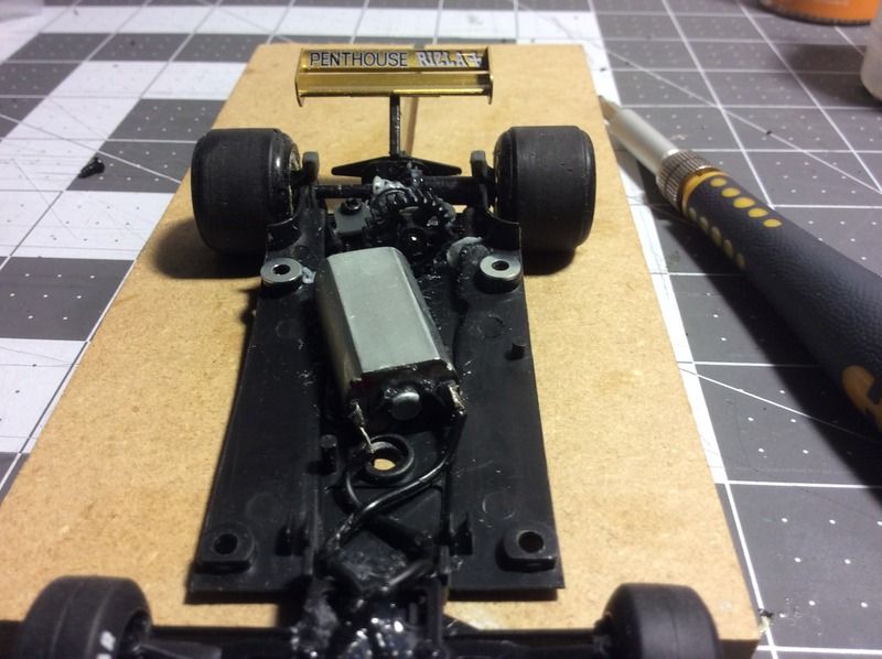

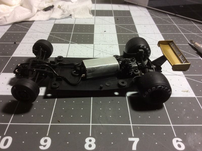

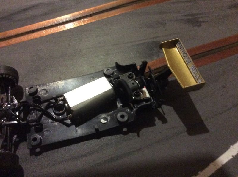

    So, for now, we'll leave the gearbox, and turn our attention to the motor. The motor cradle is pretty flimsy. I looked at the terminals to make sure the lead wires were soldered on well - which they were, thankfully - one less thing to do.

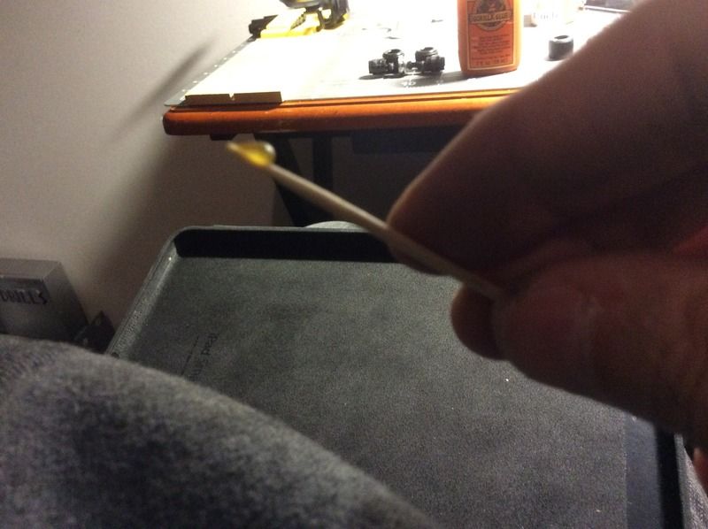

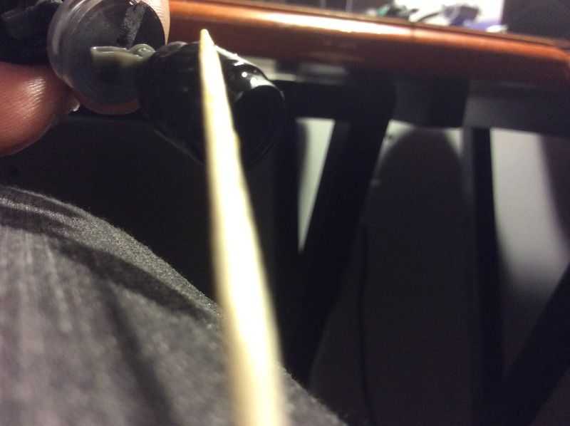

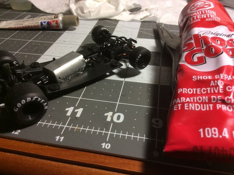

    But the motor wasn't really secure in the cradle. So, out came the Shoo Goo, and a toothpick, and presto - motor glued in.
    For those that haven't used Shoo Goo, it's easily removed if you need to.

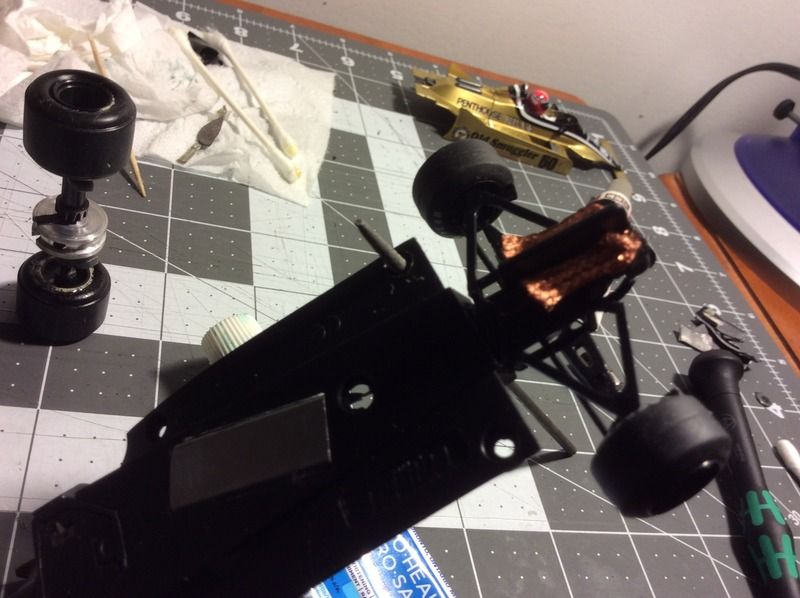

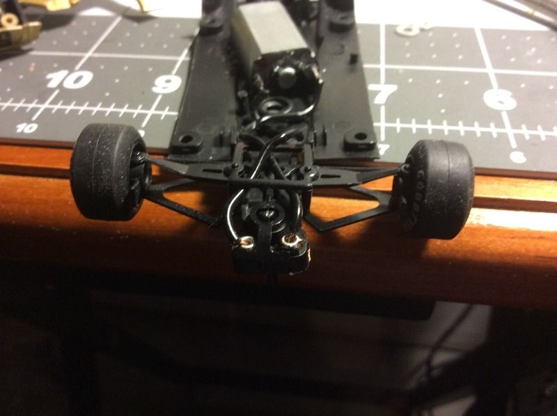

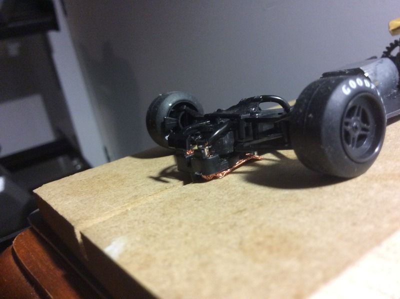

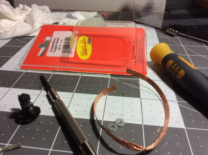

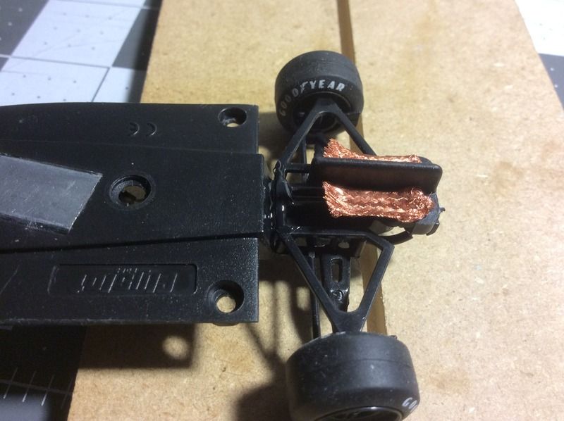

    Up next, I turned the attention to the front end. First, out came the stiff as a rock "braids" and I use that term loosely. I put in some Slot.it braid as a replacement.

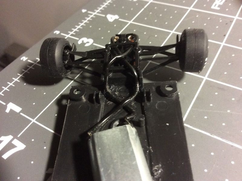

    That d@mned steerable front axle is a pain. So I started with re-routing the guide wires so they cross-cross, for a self-resetting guide (which is by the way, is the single biggest / best thing you can do in my opinion - think about the 2-3 seconds a marshal takes to rest your guide while reslotting your car in a race).
    The front axle assembly on these is quite flimsy and basically has as much vertical play you could ever want - which is also a problem.
    So fix the issue, out came to the Shoo Goo and with an ample amount I glued in the front assembly:
    Then I also applied a small amount of Shoo Goo underneath to help secure the front assembly:
    After the glued dried, I test fit the body and noticed that the lead wires that not when routed through the clip areas on the chassis (recall, I cried-crossed them for the self-resetting guide above) fouled with the driver's seat.
    So to address the issue out came my trusty dremel. With some careful grinding and then using the cut off disc...here was the result:

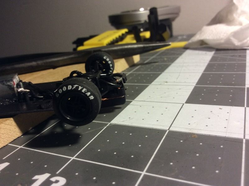

    Back to the front guide and it's steering. So now with the front assemble solid, I pried up the front tab that sits over the guide and makes the wheels turn in conjunction with the guide.
    Back to the braids. This is an area when I see a lot of people go wrong...with the braids pushing up the front nose to make it more susceptible to under steer deslots. I like to have the braids lie as flat as possible with a slight curl at the ends for good contact, using my needle nose pliers. I also like a little fraying at the end.

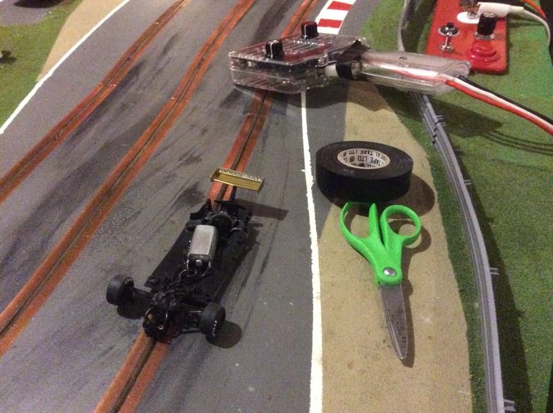

    While I was doing this, I had motor being broken in on my track running it at 6v for 18 min.

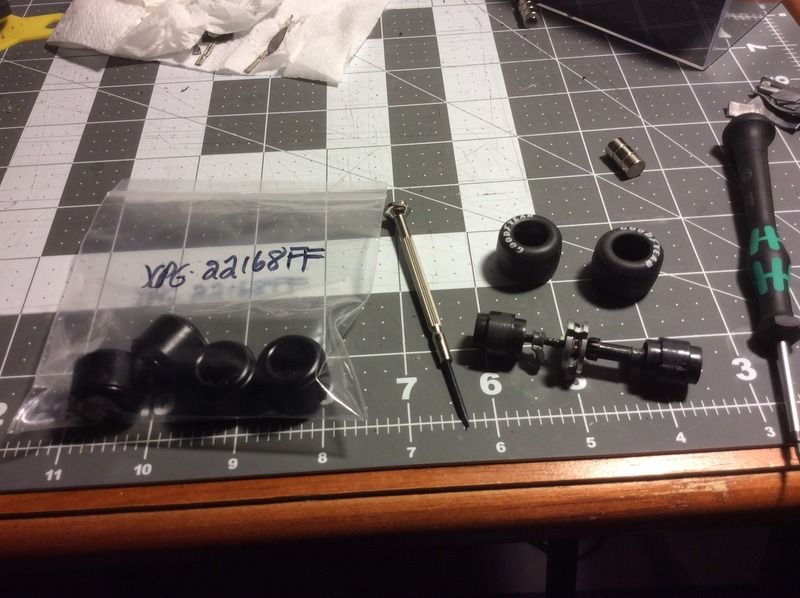

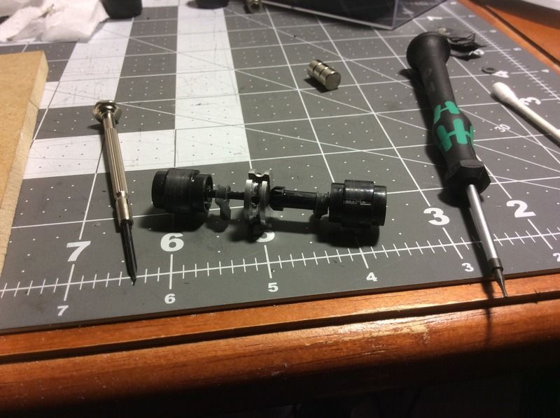

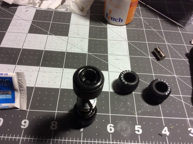

    Next, I work with the removed the rear axle and popped off the tires. And noticed straight away there was some excess plastic on the rims.

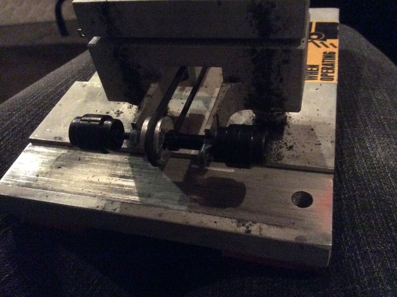

    So, off to the truer to clean up the rims:
    Then put came the appropriate Paul Gage specials:
    Then, the usual Gorilla Glue to glue the new tires on.

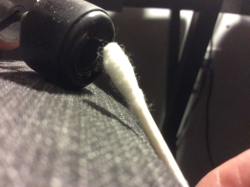

    A little lick on the inside of the tires for "water" to activate the glue. Slide the tires on, turn the, on the rims, and press roll to squeeze out the excess glue and clean up with a q-tip.
    As you can some of the bubbling starting, this is when the q-tip comes into play to clean things up.
    After letting the tires cure for a few hours, time for some truing. After progressing to finer sandpaper, then a bit of a wet sand, it was time to put the rear axle back on the car.

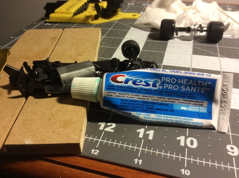

    But before we get to any laps, we'll need to break in and bed the gears using my favorite cheap fix...toothpaste.
    I usually run the gears in on 6v, anywhere from 1:30 to 2:30 min. Too long, and your gears will be toast. I like to listen - you should hear the gears quieter after 1:30, so use your judgment - less will always be better than more. This time I did it for 2 mins.
    Well, that's it, time to reassemble. Body screws to snug then backed off 1/4 turn. Oh, and a small dab of gear grease on the body screws so they ease in. :-)
    Pre-tuning, the car lapped 7.3 second range - which is way off a competitive car (March or Lotus) for this Fly F1 class. A 5.9 to 6 sec is the target range.
    So, the moment of truth...a few slow to moderate before some quick laps.

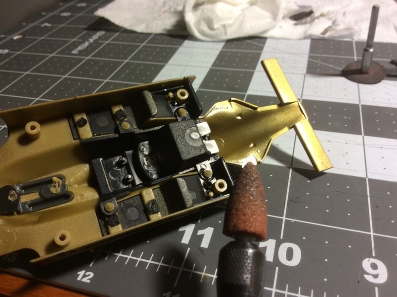

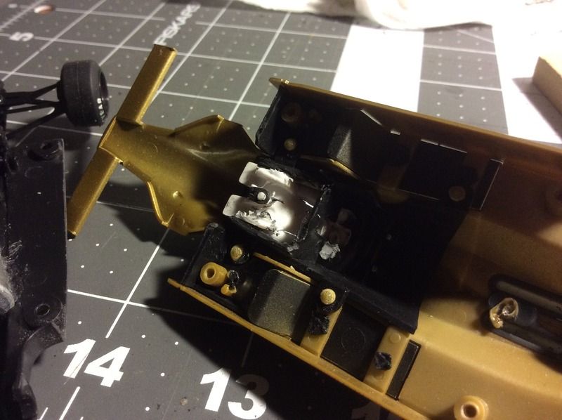

    My word, the noise is deafening! Sigh, partial fail. Seems like the shims on the idler gearbox moved the spur gear up to hit the rear deck. So how to fix it? Fight fire with fire! Put a shim on each rear body post. Glued on with a very small amount of Shoo Goo.
    But first, a little (and light - read careful) dremeling of the underside of the rear deck for extra clearance.
    Everything put back together now :-)

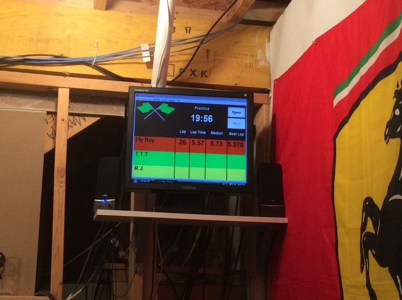

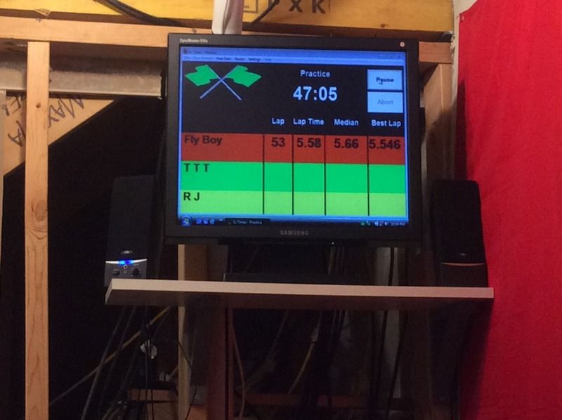

    Took about 10 laps, the noise is mostly gone. Here's the results:
    So a 5.57?! About .15 quicker than any other Fly, and about .25 to .30 quicker than comparable Lotus', Brabhams and Marches. Am I satisfied? Nope. I wanted a little less noise (just in case the spur gear was still rubbing). So I added one more shim on top of each of the rear body posts (that's two on each now).
    Back on the track...
    Okay, a 5.546. Let's call that good enough!
