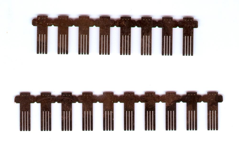

                My club races on both railed and braided tracks. Regular HO cars are made to run on tracks with rails, if you run them on a braided track you will probably have to fuss around with the pickup shoes to be sure that they run flat on the braid. You did say that your braid was slightly raised. My experience has been that you will have more problems with poor contact if the braids are flush with the track surface. Braided pickups work better when your track has braid, if you have not done so you might try using a car with a slide guide. Another thing that has worked for me is the "Braiders" that Ed Bianchi had made. Those clip on regular pickup shoes and will make better contact.
                  Yup. Shoes can be finicky on braid. Must be absolutely riding flat and also be clean.

                          Short of the braid shoes, I'll just do what I've already done again and see what happens. It still seems really strange to me that now its only one direction.
                            Missed RichD's last post. I take it back about wondering why its only one direction. I'll also try going slower in the direction that works and see what happens.
