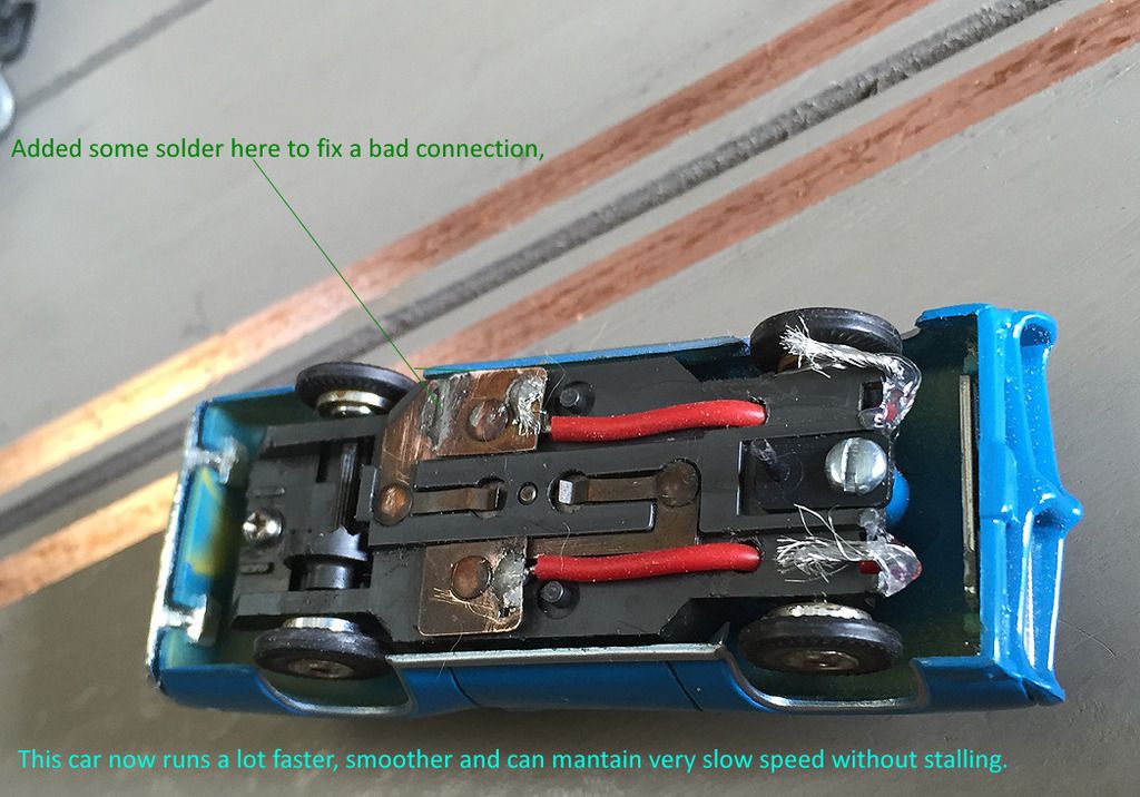

    My initial findings were no so good. I only had one T-Jet car that would run but it still stalled a lot.
    Sanding the tape with 220 sandpaper helped only a little.
    Removing the shoes and springs and going with soft silicone 24 AWG wire made a huge improvement.
    They are a lot faster, smoother and can go very slow without stalling. I am very impressed.

        I am so impressed with the wire pickups on my T-Jets. I am never going back. :-)
        the tape is pretty flat allowing nice slide action off the corners. Never was a big fan of Magna-Traction. Gravity is enough for this old guy.

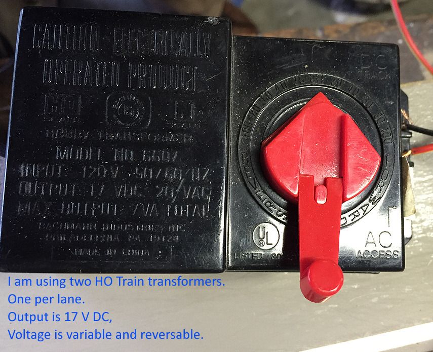

        And a couple Parma Econo controllers. Used is all I can find. I already ordered the 90 ohm resistors.

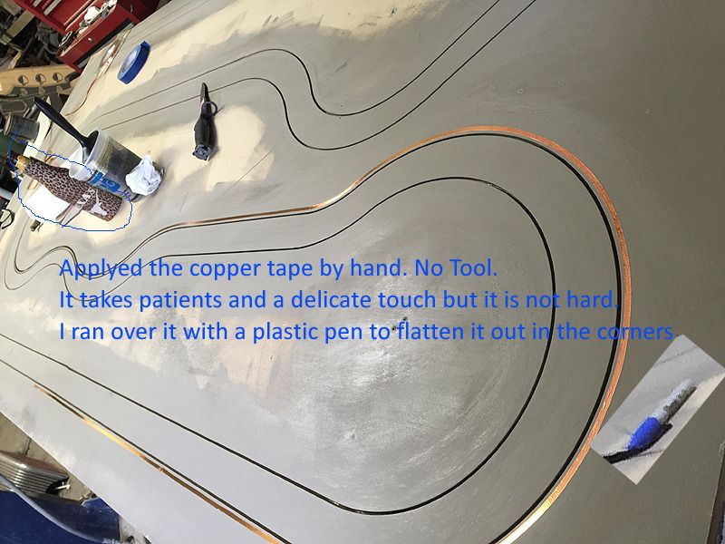

          Very nice. I tested copper tape on a small oval. I was able to build a really simple tool for applying the tape. It was simply a small piece of plywood/plastic with a nail/pin which ran in the slot. There was a hole in the plywood/plastic which the tape ran through from above. Just before going through the hole the backing is removed, the tape passes through the hole and the plywood/plastic piece presses it down as you move along.

            you have a great looking track!! I'm glad you figured out the trouble with your car. I routed a three lane track with great success. Running a car wide open is never an option with a routed copper tape track.
            keep posting.
              I like your idea of using the train transformer. I'm using three transformers plugged in to an outlet with a dimmer switch to lower the voltage to the track.
              Included is a picture of the track that I built a few years back. what I like best is the low maintenance to the track. I can ignore it for three months, turn it on and the cars run 100% of the time.

                  if you find that your cars ride high in the slots, it might be the wire you are using for the contact shoes. I ended up ordering NSR 4824 motor wire to use as my contact shoes.

                      Pretty slick bdsharp. I will try it. I have some 2mm copper solder wick.
                      My cars a nice and flat on the track with the Turnigy wire. It is very floppy. i just use what I have laying around. Like the train transformers. I kinda MacGyver'd this setup together. Lots of fun to experiment to see what works best.

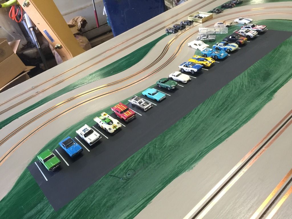

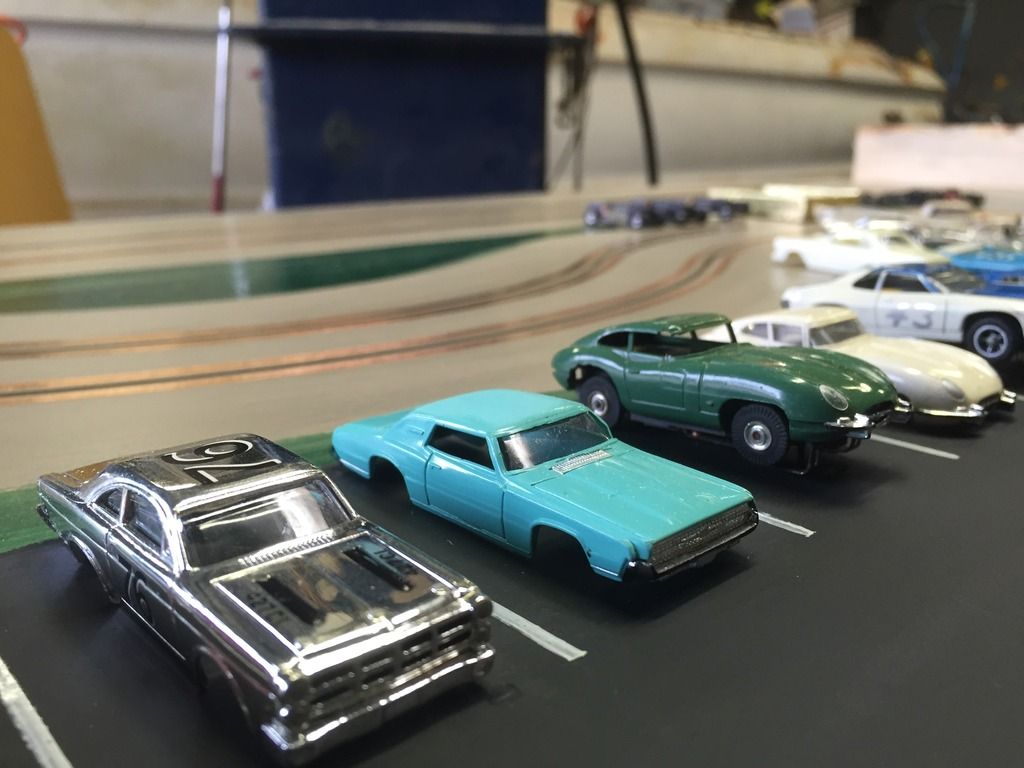

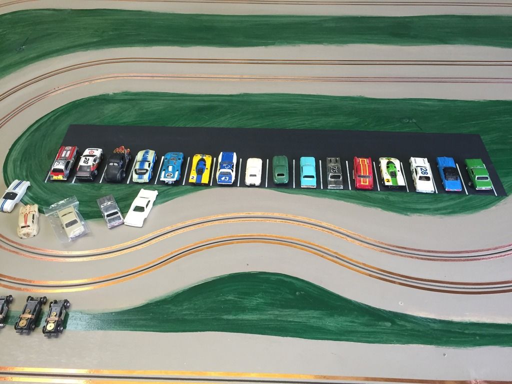

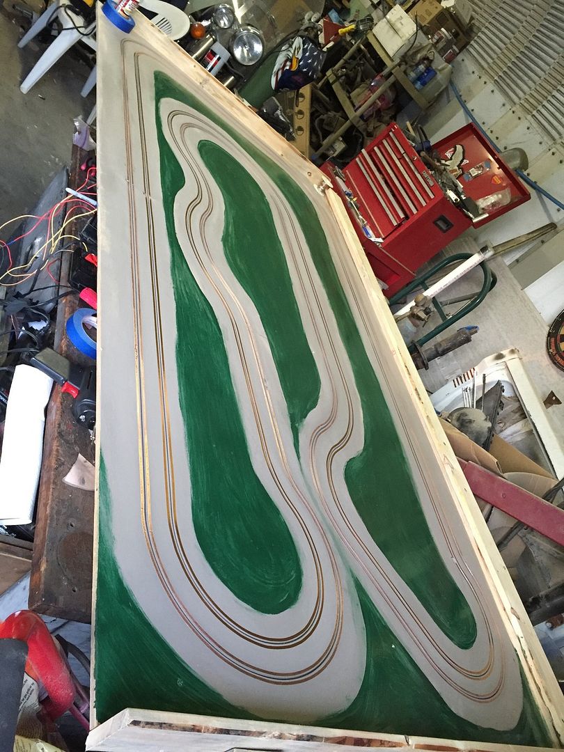

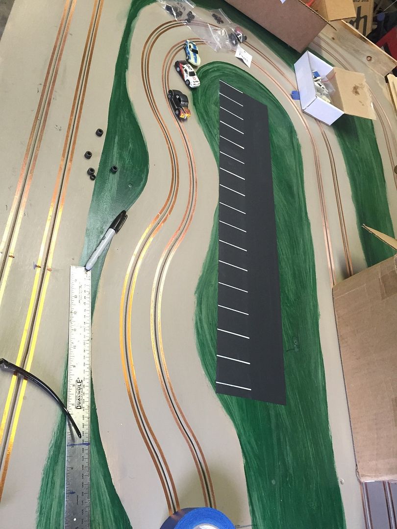

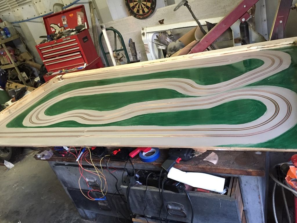

                        Layed down the second lane.
                        Painted the infield green. I will put down some proper scenery turf eventually.

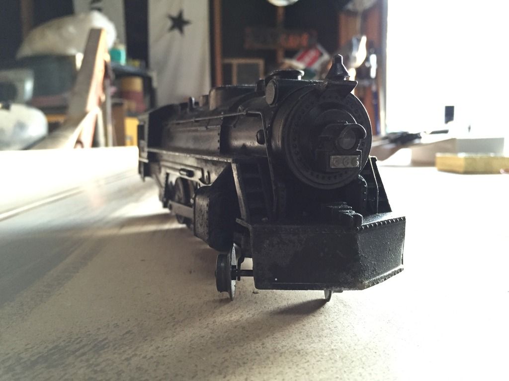

                        My really old Marx O scale locomotive. Still works fine. I need to engineer a beer delivery system with it.

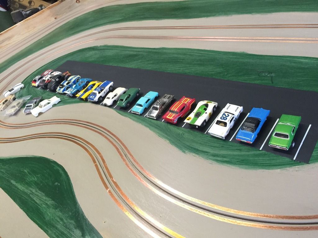

                          Added a parking lot with chalk board paint and a pigment paint marker pen.. Need to add one more. Some light towers are on the way. Also two DC volt meters so each lane can be dialed in as desired.
