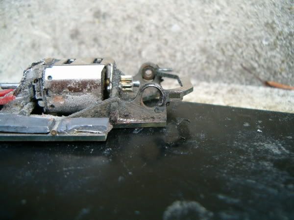

    During qualifying the gears started to make a terrible noise and after stripping down the rear end I found this:-
    It would appear that these chassis are not really up to prolonged running!....The bearing was fine, it was just the surround that had worn away. No way to repair it, (the one the other side is going the same way), I'm afraid the chassis is a scrapper..........I'm gutted but anyhow....the race must boggity on.........
    Alan, can you epoxy the bearings into the frame?
    It looks like the left bearing seized on the axle, and spun the bearing in the upright. A new bearing (or the old one, if it fits the axle nicely) could be glued in place, with a heavy glue that fills the opening in the upright bearing support.
    Did Milan's chassis have oblong holes to allow you to choose the height of the bearings? Or did the holes wear into oblongs? I suspect you need a new gear, too!
    You can still fix the thing in time for the next race, if you choose to do so. There is a penalty for a repair this drastic:
    "Major repairs which take longer than race time, such as chassis fix, guide fix; gear or motor replacement, will be completed at the track, but car will be listed as “DNS” or “DNF”, and will receive no lap credit for that race. If car owner wishes car to be sent home for repair between races, car will miss one race. This could be the race just completed, at which breakdown may have occurred (resulting in DNS/DNF, or race completed by a broken car), or the following race, by owner's choice."

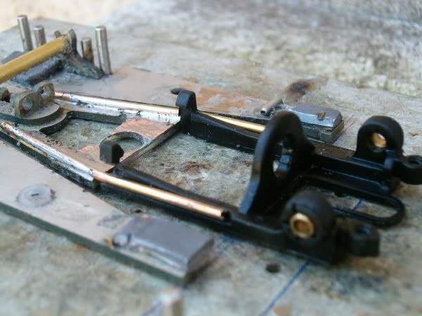

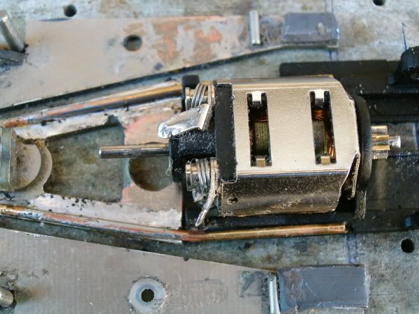

                    Having thought long and hard about withdrawing my car due to it's unfortunate bearing failure and encouraged by some very nice PM's, I thought I would have a look to see what could be done to raise this Pheonix from the Ashes.....after all we can't let those Porkies get away with too much can we?........
                    I checked out Roberts excellent suggestion but I just couldn't see a decent solution to getting enough "meat" into that bearing housing for a lasting repair, so I came up with this:-
                    Another view with the Motor in position:-
                    As you can see, like it's owner, it is very simple....just two brass rods soldered to the main chassis section, one very cut down Slot.it Pod, (My Kenwood Porsche was not happy about donating it's pod!), fixed into position by good old JB Weld, (the strongest stuff I know of).
                    I don't think this chassis will give any advantage over the existing set up as the pod will be fixed "solid" and only flex with the chassis, plus I can use existing motor, axle, wheels and tyres. The only change necessary will be a new pinion and crown as the originals were pretty much destroyed as a result of the bearing failure.
                    I'm more than happy to accept Roberts ruling, it seems more than fair to me, and agree that I won't receive any distance for this round.
                    If anyone is unhappy with this solution, or the continuation of my entry in this series please let me know...the last thing I want to do is upset anybody.
                    Racing should start tomorrow....Good luck to all competitors
                    • Alan, your solution is acceptable within the rules we wrote for the GPR last summer. These rules have remained the same, but this is the first time the penalty part has been needed, because this is the first time a GPR car has been rebuilt.
                      Rather than deny credit for an entire race, bring the car back onto the track after it is fixed, qualify for best lap time, and miss only one heat as penalty. Missing the entire race at Midford Combe is too much. I think we can interpret the rule to say a car which needs this much repair misses only one heat or segment, not the whole race.
                      It looks like a good rebuild job, too, and with a Slot.It rear end you can't go wrong. If anything, the gear mesh will be smoother, and the car should go faster and last through the series. And please take all the time you need; your efficiency in racing these cars in a timely and organized fashion, with great photos and descriptions, is appreciated! Thank you!
