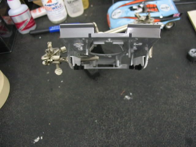

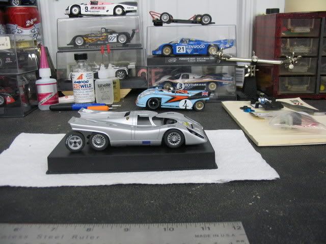

            Here is where I'm at so far.
            Slot.it HRS mounted with several challenges. One being the curved body of the 917 and me nearly melting the body by using industrial strength 2 part plastic welder. Never again! This stuff is even sold at my LHS.
            Wheel inserts will be replaced with ones like the originals.
            After visiting my LHS, I'm going to return to look at their line of paints for this car. The HOK Kandy "burple" I had for this car was thrown away at the shop. The painter said there was less than half a pint so he pitched it. That was more than enough to paint 10 slot cars. Oh well. Livery is still kinda sorta secret and will be fantasy livery for sure. Van, shhh!
            This pic shows where I add a piece of styrene (sp?) to glue the HRS body mounts too. The 2 part plastic welder I used melted holes in the plastic channel I added to the 917 body. After removing the channel the sides of the 917 were like rubber. Everything is fine now.

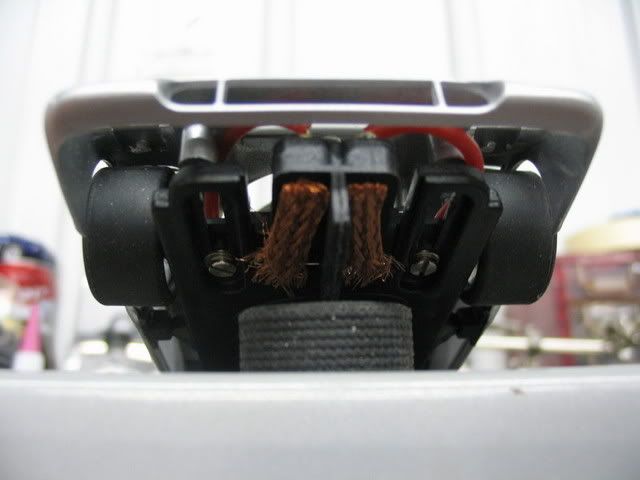

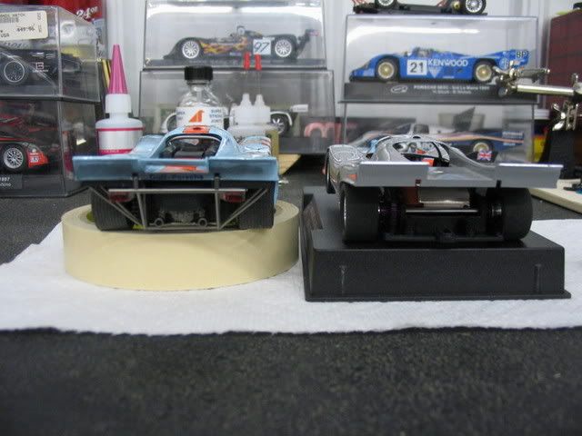

            As you can see the 917 body screw posts interfer with the guide wires of the HRS chassis. I'll dremelize the posts and clearance will be more than adequate.
            Attention to detail. Replacing the rear body hardware will be easy. I'll have to give the rear of the HRS a slight haircut and trim the bars below the tail lights.
            This ride is powered by a Slot.it 21.5k motor. Ratio is 3.27 (36/11). I'll test the car with the 3.27 and work my way numerically lower (higher ratio) with the 34 and 32 tooth 18mm spur gears. If the lap times are slower then I'll swap the 11 tooth pinion for a 10 and try the 34/10 and the 36/10.
            Rear tire choice is still undecided. I have S1's and P3's here and will try to get a set of Ortmans to test. I have a set of Jel Claws and might try them again even though I already know how they will perform.
