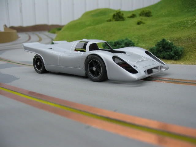

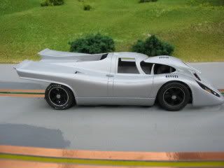

                        Is the car going to get a coat of clear now that the decals are on? Did you use Tamiya Spray Lacquer rattle cans on the body?
                        I have (Tamiya) paint and clear for the 917 and will attempt to paint it today.
                        • Nice. Very nice.

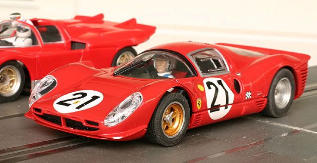

                                Fly Ferrari 512S (left), Scalextric Ferrari 330 P4 (right). P4 has added black border around hoop of windshield, relieves lowbrow look:
                                P4 has MMK wheels and tires on front, with turned-down Scalextric wheels as inserts. Rear has Fly Racing wheels, no inserts yet. Wheels and tires are true 1/32 scale.

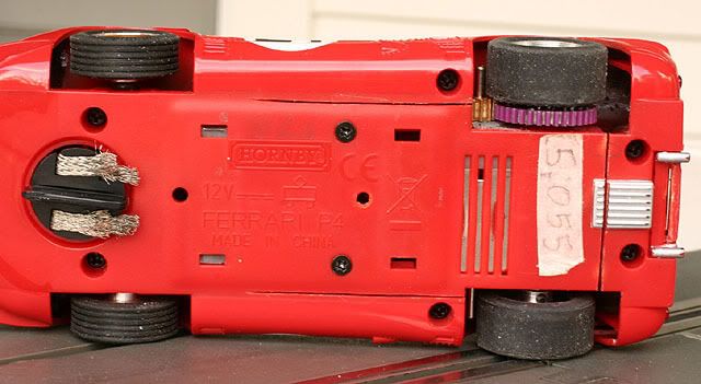

                                P4 has original Scalextric chassis/lower body, with saw cuts across pan at rear, and along sides, which allow chassis flex as if it has a sprung motor pod. A few things were cut inside to allow free pod movement. All screws are backed off, except two rear screws hold tail pan tight. Handling is excellent, far better than before the cuts:
                                Additionally, P4 has old Slot.It 26k which works well with 3.6:1 gearing. Car uses cast-off parts, except for Jel Claws rear tires. Without the flexible frame, it could not have handled the power of the Slot.It motor.
