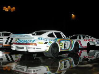

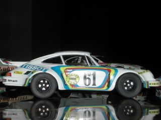

        So I shot a coat of Tamiya TS13 clear on both cars this a.m. and headed off to work. When I got home this evening, both cars had a great glossy finish. I should have shot a bit more on the sides, but it seems to have worked out ok...especially since my paint jobs have mostly sucked up until now.
        I've been giving both cars repeated coats of the Turtle Wax iCE product. I'm not sure if its doing much since the Tamiya clear came out pretty good to start with. I've been working on putting non-functional lights in the 936.
        I ditched the 2mm thick MRRC lenses that came with the 936 in favor of bits of clear blister pack cut out to fit. I guess I should do the same thing for my Scaley MG Lolas some time. I even made an amber marker light on top of the airbox with a dot of yellow paint, and a built up little blob of Micro Kristal Klear.
        I used a similar technique to make some tail lights: painting some styrene stock red and then building up layers of Micro Kristal Klear over it.
        The Micro Kristal Klear goes on white like in the photo above but dries clear. Great stuff! You can just keep building up layers of it.
        Painting weatherstripping on the 911 was tough. I'll have to figure out a better technique for that.
        I'm sure by the time these cars are done, my modelling skill level might hit "2" on the Airfix scale. Patience is a virtue, that's for sure. Looking forward to some track testing at Raceworld on Friday.

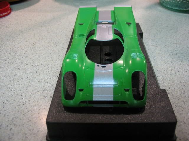

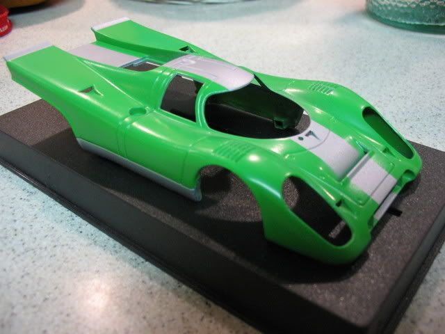

                              • GPR 917....coming alive!
                                Its painted. Thought I'd try a different shade of green. I'm going to attempt to paint a thin black stripe on both sides of the silver center stripe and weather the thing a bit. Livery will go on next then it will get some clear.
