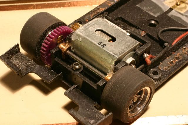

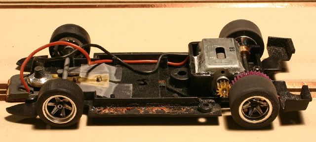

                I'm poking along with a Fly Classic Lola T70 Mk IIIB coupe, currently approaching competitive speeds with a Slot.It 25k in the loosened Fly motor pod. BWA wheels, Ortmann tires (Fly Classic size), Slot.It axle and bearings, and Slot Car Heroes 36t spur gear (purple plastic). The gear is a press-on, which spun on the axle, so I drilled and tapped for two 2-56 machine screws from the gear to the back of one of the BWA wheels. It works!
                Guide is a cut-down Parma, riding in a brass tongue screwed to the front of the plastic pan. Although the body is P class, the technical aspects of the chassis are consistent with GT. I guess I'll be cutting a magnet into the motor pod eventually.

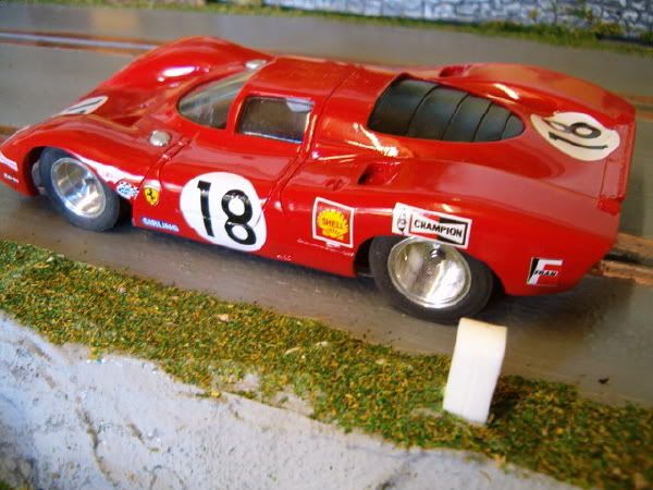

                      Current progress on my Prototype car :-
                      The wheels are BWA and rears are currently standard Fly Classic Ferrari, (awaiting new Ortmans). Fronts are currently Scaley GT 40's. I do have a question, is it OK to use these front tyres are do you want me to use the Fly ones?....The diameter is the same for both, the GT 40 tyres are a slightly smaller overall width but fit the chassis better.
                      The Falcon is way too much power and I'm currently looking at different motor options. The guide tongue has yet to be added, I will use a TSRF Guide.

                          I think the tires look fine, but the chassis is way too nice you shouldn't be allowed to run that Alan, must be a shelf queen! Just kidding you, what a great looking entry! What's the story on the body?

                            Thanks Robert, you have answered my question, and saves me cutting the chassis too much.
                            Eric. The body is a resin shell made by a Company called TKP in France. I belive TKP is part of the MMK setup. Doc P is the best man to give the lowdown on the Company. The shells are supplied pre-painted.
                            The 312P Ferrari (IMHO the prettiest Ferrari ever), is also available as the spyder version, which one of my friends has just finished building.
                            The shells are not too heavy for resin, although I may do a little dremmel work on the inside to reduce weight.

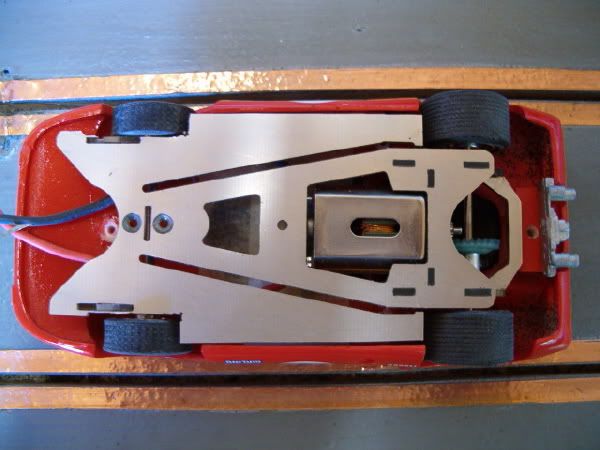

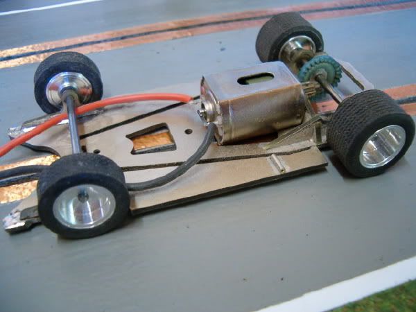

                            The chassis is one of Milan Tomask's and is superb. We think they are made from PCB. They are certainly very lightweight, and seem to go well.
                            I really don't know what motor to use at this stage. I would like to try one of the new Proslot Euromotors, but I'm not sure the current release would be quick enough.

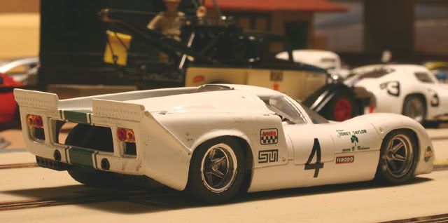

                              Lola T70 Mk IIIB, Fly Classic, aspiring to competition in the GPR P class:
                              BWA wheels at rear, with turned down Fly wheels as inserts, Ortmann Fly Classic tires:
                              Veteran plastic chassis not really up to the job, is twisted. Motor pod rides on a single screw at rear, tab at front, floats like a Slot.It. Brass tongue carries cut down Starburst guide. Magnet will go just ahead of motor in pod, where Fly intended.
                              Slot Car Heroes purple gear (36t) driven by Fly pinion (11t). Gear fixed to wheel by two 2-56 screws, seems bullet proof. Slot.It bronze bearings filed flat on one side to fit large FK motor case. Pro Slot Evo 4 motor is a handful, straightaway speed is good, but goofy plastic chassis and Ortmann hop limits cornering speed. Best lap around 5.380, not fast enough.

                                Looks like a hot setup to me RL, too bad about the hop! Looking at your fine photos ...... do you have 1.5mm clearance under the chassis? Just curious, cause I started measuring my chassis' for both GT and P, looks like I'm going to have to jack them UP from stock height in order to meet the rules
                                like that particular Lola livery too!
