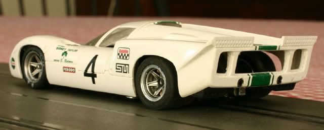

            The too-wide Lola:
            Three large holes in the tail cut out at the top, to look closer to actual photos. Tail lights yet to be re-installed. This body is tail heavy:
            Brass plate went through some design evolution. Holes drilled for lightness. Car now weighs 104 grams, handles and accelerates as if it is still too heavy. Body mounts still in progress. Car easily clears 1/16" underneath.
            Original Fly motor pod pivots on longitudinal pin inside a length of brass tubing, is transversally sprung on a crosswise length of .032" music wire. Without the spring, car hopped badly. With spring, car is smooth. Dummy Chevy motor glued atop FK motor, moves with rear pod inside cutout hole in rear deck:
            I think I have pushed this design as far as I can. Lap times still not so hot: 5.264 sec best, 5.4's usually (fast time for TSRF and Slot.It cars is 5.0 flat, with excursions to 4.9). Next step is to adapt the chassis to another body, lighter in the tail, and of course slightly narrower. Good thing I am on vacation!

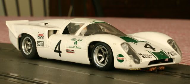

                        Robert, a couple things, first here is a pic of my Topslot Lola, which measures 2.383" at the widest point. I was just installing the correct T70 wheels, because I want to use the Porsche wheels in the pic on my GPR car. So I measured it. It seemed narrow next to my other Fly classics. It has an MRRC 275p chassis.
                        Second, how do you cut your brass chassis'? I have yet to start and was pondering the wheel of death and wondering if I had a jigsaw somewhere? Your Lola and Toy GT1 look very nice!
