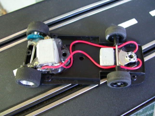

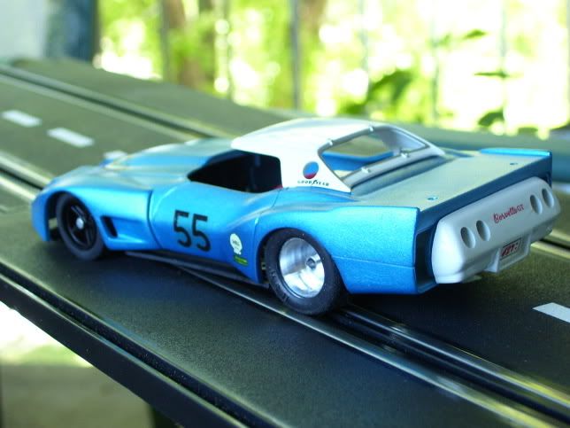

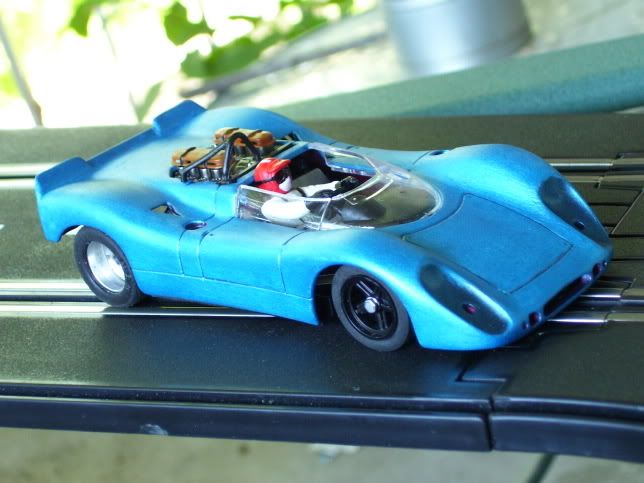

          I thought i would join the thread and post the progress on my GPR cars. Both are still in the ugly ducking stage, but comming along.
          Prototype:
          Car: Fly Porsche 908
          Motor: FK130SH
          Drivetrain: Slot-it axel, bushings and spur
          Tires: Rear are NSR supergrips on slot-it rims, fronts are monograms on stock rims
          Mods: Motor configuration has be modified to an anglewinder set up, front guide asseblely is from a 1/24 scale pan chassis.
          Body has the front aeros shaved off and is in the middle of being finished with my 'custom blue' for the GPR.
          GT
          Car: Monogram Greenwood Corvette
          Chassis is still in 'R&D' - has been converted to an inline from its stock front motor configuration, but still being worked on.
          Body: Sporting my 'custom blue' for the GPR, lookin pretty bad a@#
