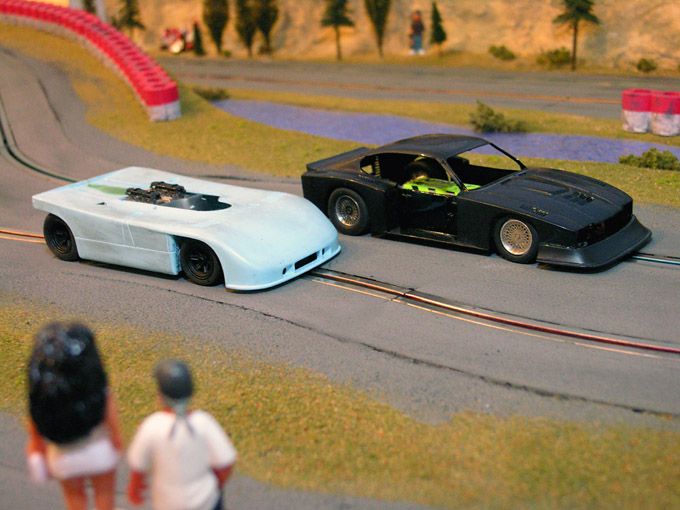

              • Jeeper's testing at the Coffin, look Ma - no drivers!

                  • Originally posted by RECKLESSRACER
                    Ha ha, they always go faster without them pesky interiors, drivers and window glass. You think you have a winner, and you put in the glass/interior/driver, and you actually have a wiener. As in dog.
                    I have resorted to vac-formed glass, a .010" sheet of styrene for the interior, and transfer of roll cage, fire bottles, and driver head from the original, plus hand made other details. This interior is held in place so it can rattle, with styrene strontium clips.
