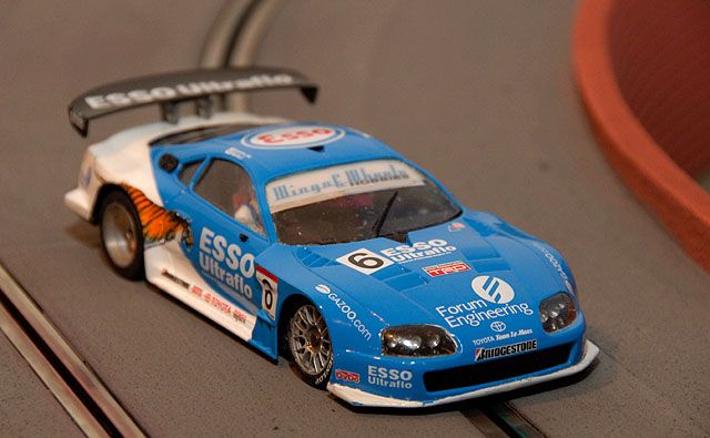

    This car sounds like no other .... hit the gas and it's like a supercharger was unleashed, we'll see how far the gears make it! Speaking of which, with taller gearing I think a better lap total could have been achieved. The top speed was reached quite early on the back straight. All in all a satisfying car to drive.
    Eric --
    Thanks for a great run! That really IS a pretty car (wish I had a bigger version of this image), even if it IS a midpack ho-hummer. And even though it's blue, THINK RED! Except for wheels, tires, and axles, this honker is pure (well, I *did* modify it a bit) Ninco -- I wished at the time I built it that Ninco had a somewhat higher gear, as the NC-5 certainly has adequate torque, but Ninco's "Pro" stuff wasn't out at that time. Ah, well -- we'll see how it fares in its swan song race.

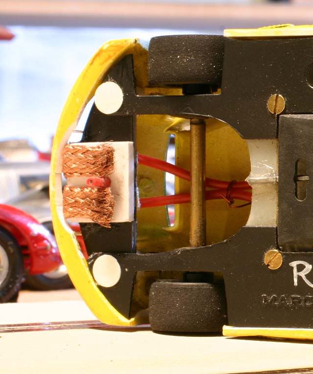

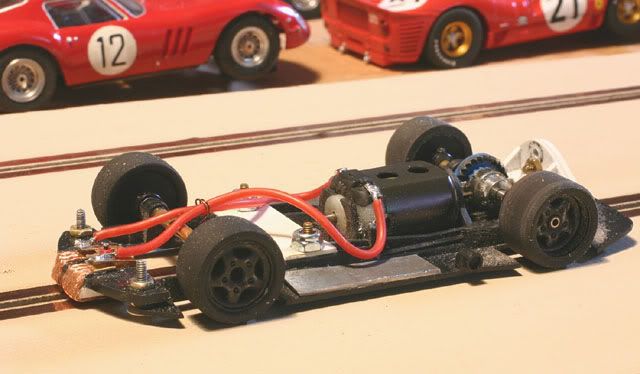

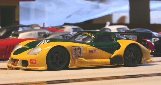

                • The Marcos has been repaired. I replaced the front frame crossmember with a new one about three times thicker, and built a pin guide in the interest of durability and simplicity. I finally trued one rear tire correctly, getting rid of some annoying vibration back there. The car runs better than ever, and I was able to reduce the lead ballast, so the car weighs 87 grams (used to be 93 grams).
                  I have no idea what this is worth in penalty points, but I think I am so far behind it won't make much difference!
                  The guide mount failed because of a design error on my part. There was no way to fix it without it failing again, thus the front-end redesign.

                          • Marcos repairs:
                            Body work at nose repaired. Gussetts which support splitter replaced, as they had been knocked off:
                            Chassis repaired. New front crossmember fabricated, with pin guide. Old pivotting guide shoe could not be re-used:
                            Underside, showing pin guide, insulated with red plastic tubing:
                            • Very Impressive repair Robert, I do like pin cars.
                              We ran a Pin car event at Pendle track last year, featuring original 50's/60's cars, reproductions and modern interpretations of the theme, some of the lap times achieved were at least equal if not better than modern guide systems.
                              You deserve a banana.....
                              • Robert's Repair
                                That Should Run Fine. Nice fix!
