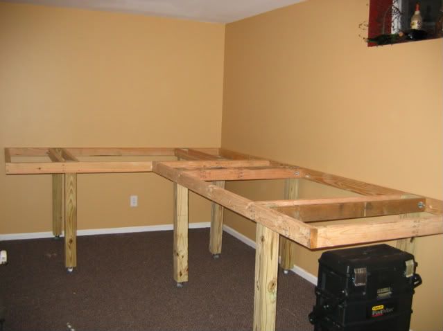

    Started making the "tables".
    First frame is done:
    Both are complete and in the basement:

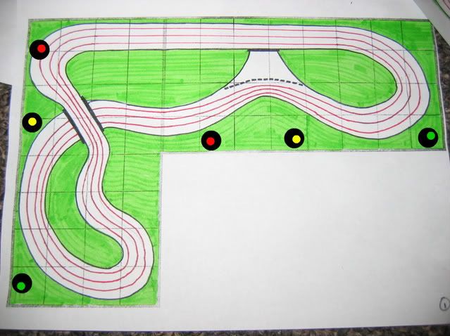

    Started drawing out the "road":

                          1. Where will the 3 drivers stations be located - just wondering about sight issues...

                            As far as the driver stations I'm still trying to work that out. I think at first I'm going to put them on the long part of the track, if it turns out that line of sight is blocked I'll add remote stations to the side against the wall and just slide the track out a couple of feet whenever people are over. The whole thing is on wheels so that shouldn't be a problem, but people would have to crawl underneath the track... Space is limited so there is only so much I can do, here is a picture of where I plan on putting the driver stations:

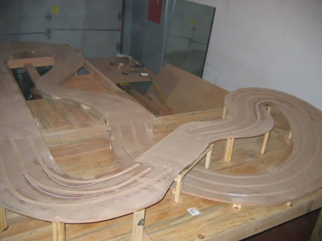

                              Together for the first time!
                              I'm really excited about this, did a little work on it when I got home and the track is one piece for the first time!! No major problems other than some light sanding is needed to make sure everything is perfectly smooth.
                              Here's the pic (sorry for the poor quality, I cleaned up and there was a lot of dust in the air):
                              Time to put some Bondo down on the bridge and then pull out Luf's excellent strip to finish the routing.
