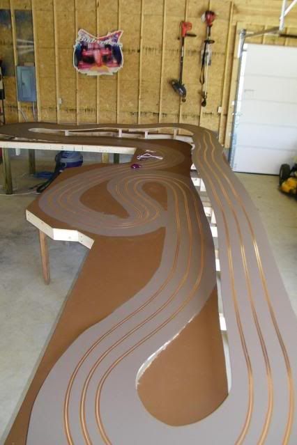

    Approx. 70' three lane wood track
    Pyramid Power Supply
    Parma 45 ohm controllers

        Just an update...I now also have a two lane routed hillclimb and a single lane parking lot autocross track.
        Copperhead Climb:
        Galleria Palms:

          Did you ever "landscape" Bibbee Ridge? It really looks like a fun layout!
          David
            It is next in line...I have all the scenery bits so i hope to start it soon now that my running of SLOP is over. It is a lot of fun to run on...at least those that have think so.
